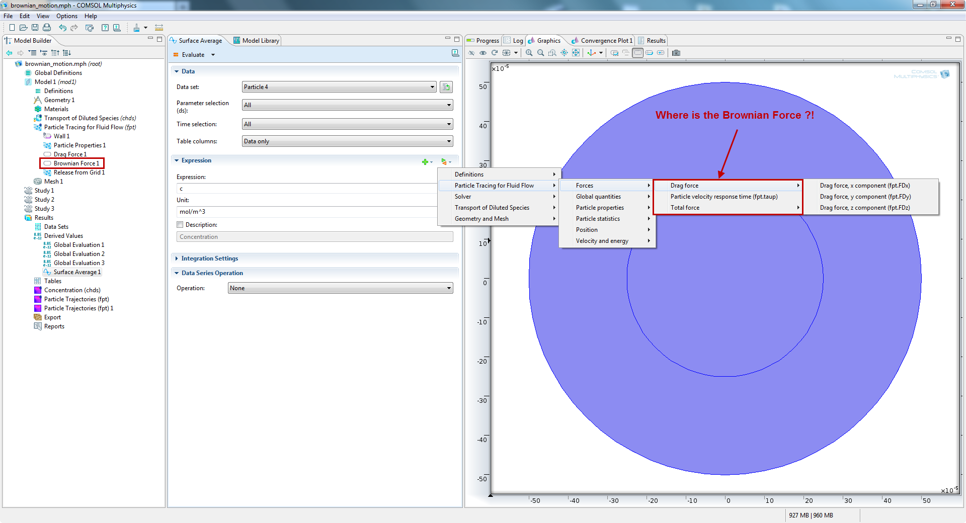

I am using the 4.3 version to calculate the Brownian forces on a 2D geometry. My model looks pretty much like the "Brownian Motion" model from the Comsol's Model Library. The solver converges and I can visualize the particles dynamics.

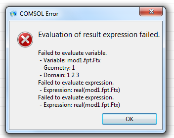

The problem is that I cannot numerically evaluate the Brownian forces values. For example, I tried using the Surface Average option from the Derived Values Menu, and I got the attached error message.
It happens the same when I am trying to calculate the values for the forces using the "Brownian Motion" model from the Model Library. I also saw that there is no specific option, after solving the problem, when trying to evaluate the Brownian Forces: I wasn't able to find a clear option for the Brownian forces as it can be found in the Results area for e.g. Drag Forces (more details in the attached image).
Is there any specific way to calculate the Brownian force that acts upon a particle or, more important, upon all the particles in the computational domain?

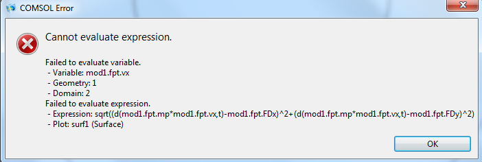

I followed your suggestion of plotting the Brownian forces using the d(fpt.mp*fpt.vx,t)-fpt.FDx expression for the ox component and the d(fpt.mp*fpt.vy,t)-fpt.FDy expression for the oy component on the Cosmol's Library "Brownian Motion" model and I got the attached error message. I also used these expressions in my model and the error is still the same.
I tried to plot the components (fpt.FDx, fpt.mp and fpt.vx) separately and, again, I got the "Failed to evaluate variable" error message.
Could you please help me find out what am I doing wrong?

Hi, you can't make a surface plot of any of the particle variables since such variables do not exist on the physical geometry. The only way you can see forces on particles is via the Color Expression of a Particle Trajectories plot.
