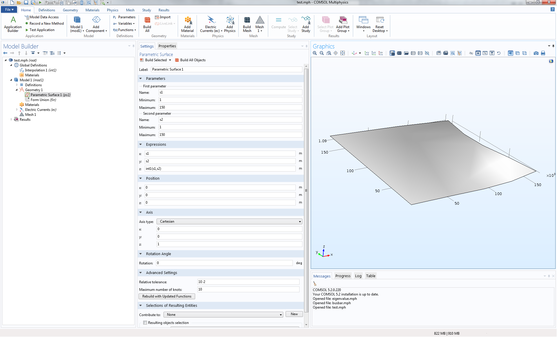

Posted: 9 years ago May 24, 2016, 1:21 p.m. EDT
Hey,
I am new to COMSOL and am using version 4.2.
I am trying to build a model with surface topography. I have the x, y and z coordinates in a .txt-file. When I set up the function "Interpolation" I can only draw the function if i check "use space coordinates as arguments" box. But then I get a fatal error if I try to set up the parametric function: Fatal error during assembly or evaluation.
If I do not check the space coordinate box then I cannot draw the function but do not get the fatal error when trying to build the parametric surface but also I do not get the right topography.
Does anyone know where the problem can lie? Attached is the mph file
Thanks in advance!
Hey, I am new to COMSOL and am using version 4.2. I am trying to build a model with surface topography. I have the x, y and z coordinates in a .txt-file. When I set up the function "Interpolation" I can only draw the function if i check "use space coordinates as arguments" box. But then I get a fatal error if I try to set up the parametric function: Fatal error during assembly or evaluation. If I do not check the space coordinate box then I cannot draw the function but do not get the fatal error when trying to build the parametric surface but also I do not get the right topography. Does anyone know where the problem can lie? Attached is the mph file Thanks in advance!
Jeff Hiller COMSOL Employee
Posted: 9 years ago May 24, 2016, 2:14 p.m. EDT
Hello Sina,
You may want to update your license to the current version: in 5.2 your file works right out of the box, see screenshot attached.
Best,
Jeff
Hello Sina, You may want to update your license to the current version: in 5.2 your file works right out of the box, see screenshot attached. Best, Jeff
Posted: 9 years ago May 24, 2016, 3:00 p.m. EDT
Hi again,
Sorry, I don't have 4.2 any more.
Attached is the screenshot after I increased the ranges for s1 and s2 to 1500. You'll notice that I increased the number of knots from 10 to 100 to capture your elevation data better.
Best,
Jeff
Hi again, Sorry, I don't have 4.2 any more. Attached is the screenshot after I increased the ranges for s1 and s2 to 1500. You'll notice that I increased the number of knots from 10 to 100 to capture your elevation data better. Best, Jeff
