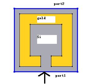

I have some problems when making the model. I have a split ring resonator on the Si substrate. A beam of light is incident vertically on the ring. I use the ports and want to calculate parameters S11^2 and S21^2.
To the substrate ,the electric displacement field model should be relative permittivity or refractive index? In the port mode settings, I set E0x=1 and other two components are zero. The propagation constant is k0. I use wavelength of parameter sweep.
The result is that S11^2 has the lowest point and the S21^2 has the highest point. It is contrary to the theory. I can't find out the problem.
Hope you can help me!
Hello, I have some problems when making the model. I have a split ring resonator on the Si substrate. A beam of light is incident vertically on the ring. I use the ports and want to calculate parameters S11^2 and S21^2. To the substrate ,the electric displacement field model should be relative permittivity or refractive index? In the port mode settings, I set E0x=1 and other two components are zero. The propagation constant is k0. I use wavelength of parameter sweep. The result is that S11^2 has the lowest point and the S21^2 has the highest point. It is contrary to the theory. I can't find out the problem. Hope you can help me!

Posted: 1 decade ago Apr 16, 2013, 7:45 a.m. EDT
I delet the mesh,the ports and down size of the model. It fails all the same. So I attach the sketch map.
Thank you!
I delet the mesh,the ports and down size of the model. It fails all the same. So I attach the sketch map. Thank you!
Posted: 1 decade ago Apr 16, 2013, 7:48 a.m. EDT
I delet the mesh,the ports and down size of the model, but it fails all the same.So I attach the sketch map.
Thank you !
I delet the mesh,the ports and down size of the model, but it fails all the same.So I attach the sketch map. Thank you !
