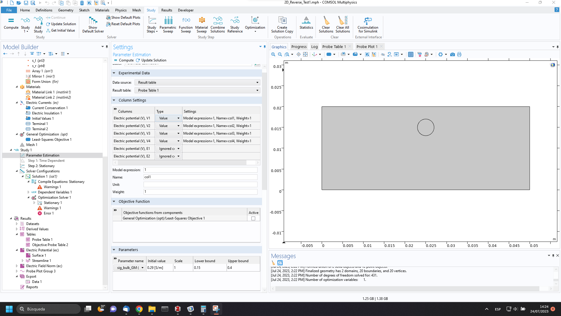

Hello, I'm a PhD student doing biosensors. I'm working on a model to obtain an estimation of conductivity based on the signals from real data. The idea is that I have 4 sensors with voltages, and I should be able to see how conductivity change at different levels below my sensors, if possible as a map. I've been searching information about the optimization module and the parameter estimation used for inverse modelling, but haven't been able to pull it off. Thanks in advance!

You might benefit from taking a look at this model.
You might benefit from taking a look at [this model](https://www.comsol.com/model/4410).
