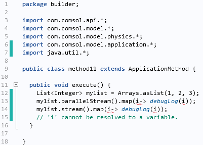

Is there a way to run parallel code in Model builder? Here is example:
package builder;
import com.comsol.api.*;
import com.comsol.model.*;
import com.comsol.model.physics.*;
import com.comsol.model.application.*;
import java.util.*;
public class method11 extends ApplicationMethod {
  public void execute() {
    List<Integer> mylist = Arrays.asList(1, 2, 3);
    mylist.parallelStream().map(i-> debugLog(i));
    mylist.stream().map(i-> debugLog(i));
    // 'i' cannot be resolved to a variable.

HI Edgar, thanks for answer. There is way to use methods during computatin but basically I use JAVA methods for post processing.
The example I provided is legit JAVA code which works but not in Comsol. Thanks for the idea with external DLL. It's great and useful tool but it does not fit what I want to try.
For example we have parametric sweep with 3 steps, where 1, 2, 3 are indeces of those steps. In postprocessing we need to perform Global Evaluation for each step independently. I will omit imports, class name and execute method of the class method11 and show simple example:
int[] indeces = new int[]{1, 2, 3};
for (int i: indeces)
    with(model.result().numerical("sol2"));
        set("outersolnumindices", i);
    endwith();
    model.result().numerical("gev1").setIndex("expr", "2+" + toString(i), 0);
    model.result().numerical("gev1").setResult();
double[][] table = model.result().table("tbl1").getReal();
Previous code is a sequence. Next example suppose to be legit equivalent of previous.
List<Integer> mylist = Arrays.asList(indeces);
mylist.parallelStream().map(i-> {
    endwith();
But this code should run for each index i an independent subprogram in the same time.
I suspect that it's impossible to do in the way I want but at least to have an option to run parallel JAVA code would be nice.
Best Regards, Kostiantyn Vasko
