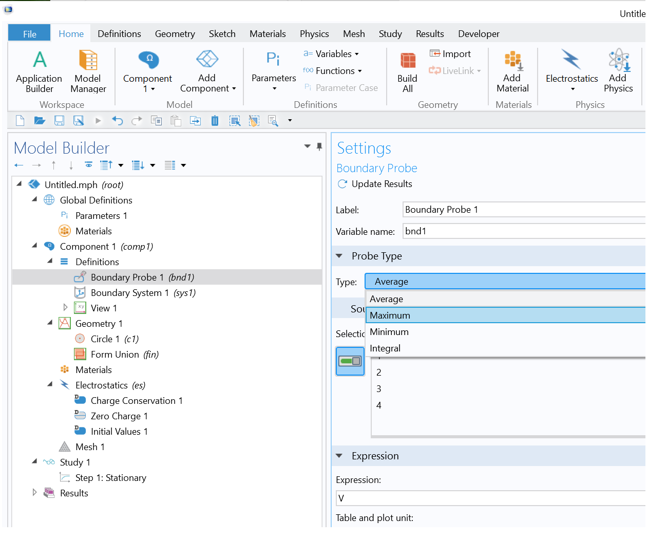

Have you considered using probes? See snapshot attached. You can find maxima, minima, and averages over boundaries, surfaces, volumes, etc.
