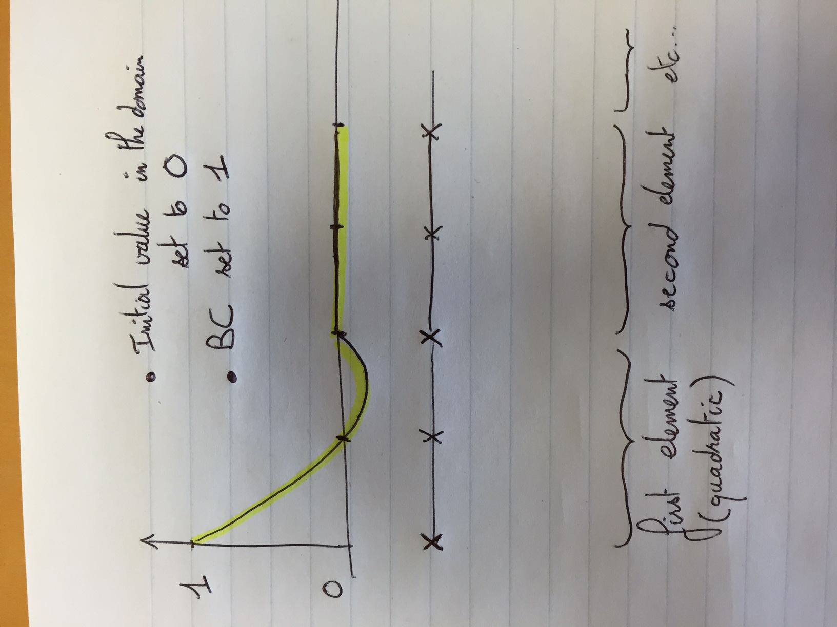

I have seen this now in 2 simulations... The initial values specified in Initial Value Domain nodes are NOT the Initial Values the solver ouputs, either at t=0 of the solution nor when asking the "Get Initial Value."
Is there a reason for this as the Initial Values are being changed dramatically when solving (i.e. half the value for IVs that had value, and non-zero for some IVs that were zero)?

The reason for this is likely that you specified initial conditions that are inconsistent with the boundary conditions you picked. At t=0, this inconsistency causes under-/over-shoot in the first element next to the boundary (assuming that you are using quadratic elements, which is the default for most physics), see attached picture showing what I mean in 1D.
The solution consists in specifying consistent conditions. If for instance you are trying to model how a system responds to a sudden ramp-up of a field on a boundary, then use a function that starts at the initial value and ramps up to the final value in your BC. Instantaneous changes in value are frequently unphysical anyways.
