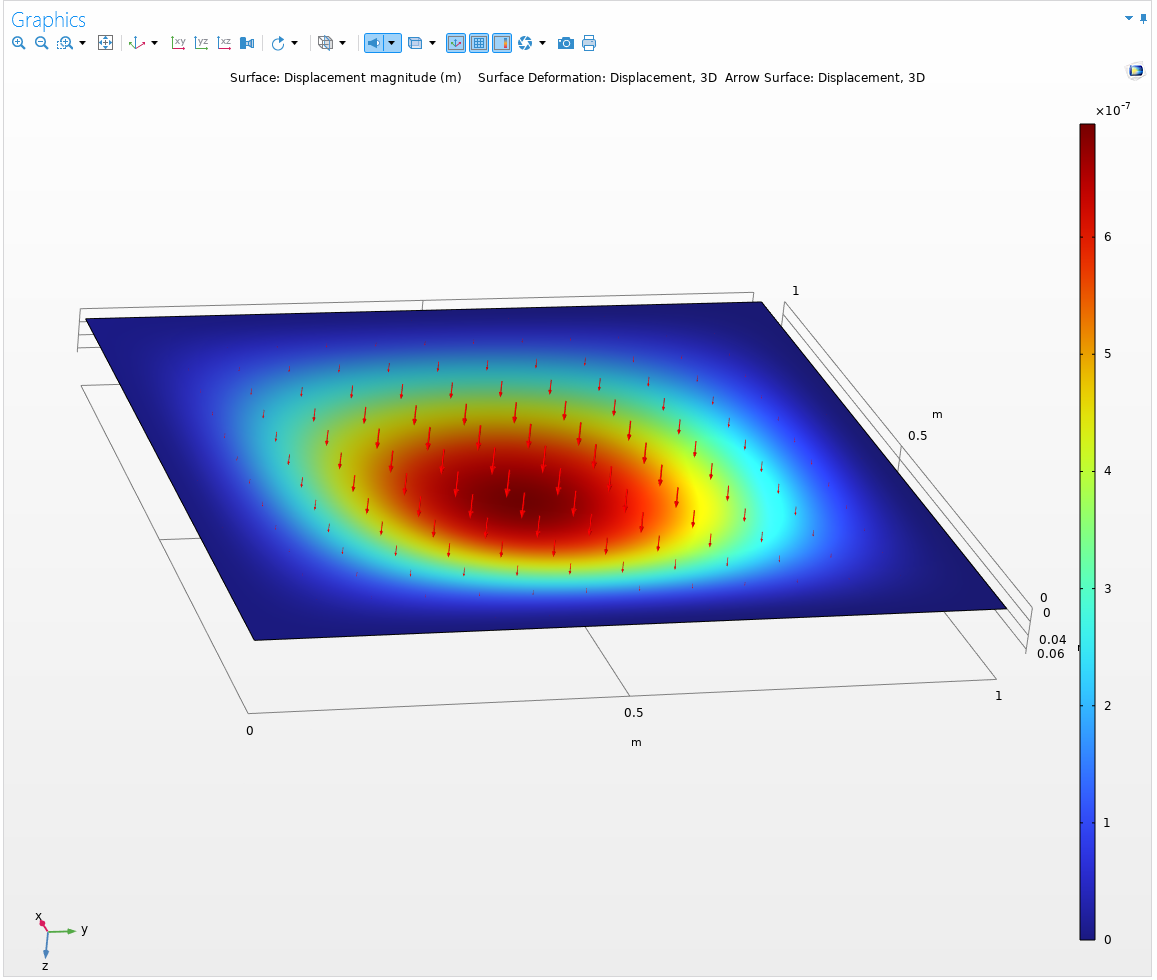

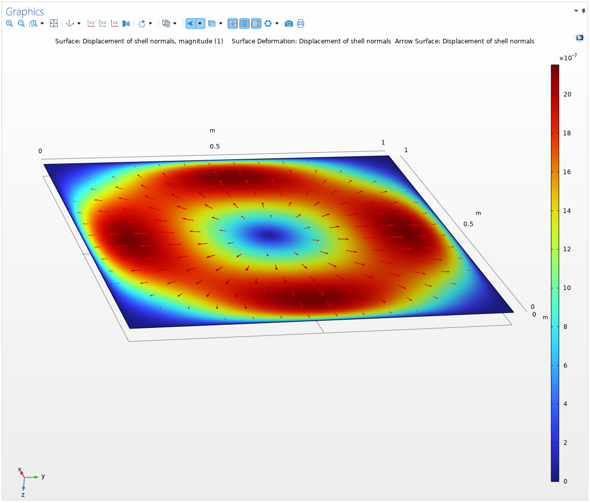

I am investigating the deformation of a square thin plate with four fixed sides subjected to a uniform load.
I modeled the thin plate using shell units and got the results at steady state.
The simulation results are in the attached file. Figure 1 shows the displacement and Figure 2 shows the normal displacement.
My problem is that the normal displacement doesn't seem to cause any surface deformation. And it is not pointing in a direction perpendicular to the sheet.
What is the difference between normal displacement and displacement?
Thank you for your help.

The variable named Displacement of shell normals ( not Normal displacement ) is a quantity measuring the rotation (in terms of displacement of tip of normal vector). It is the rotational degree of freedom in the shell formulation. Please refer to the theory section in the Shell chapter for more details.
Henrik Sönnerlind
COMSOL
The variable named *Displacement of shell normals* ( not *Normal displacement* ) is a quantity measuring the rotation (in terms of displacement of tip of normal vector). It is the rotational degree of freedom in the shell formulation. Please refer to the theory section in the Shell chapter for more details.
Thank you very much for your answer, it helped me a lot!
If Displacement of shell normals doesn't mean Normal displacement, then where can I find Normal displacement?
I need the displacement perpendicular to the initial shell surface, but I can't find the variable Normal displacement in the results.
>The variable named *Displacement of shell normals* ( not *Normal displacement* ) is a quantity measuring the rotation (in terms of displacement of tip of normal vector). It is the rotational degree of freedom in the shell formulation. Please refer to the theory section in the Shell chapter for more details. Thank you very much for your answer, it helped me a lot! If Displacement of shell normals doesn't mean Normal displacement, then where can I find Normal displacement? I need the displacement perpendicular to the initial shell surface, but I can't find the variable Normal displacement in the results.
