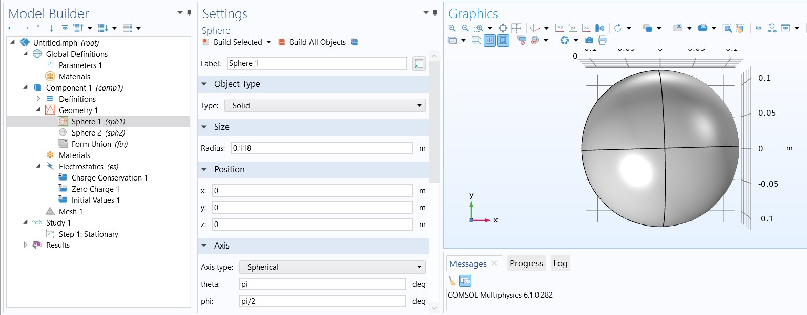

Hello Leonardo,
What you did in that screenshot is that you rotated the axis of the sphere; this is why you are not getting the output you expected.
As a side note, you are specifying those rotation angles in degrees right now: notice the "deg" unit to the right of those two text fields.
I assume that you want the angles theta to be between 0 and pi radian and phi to be between 0 and pi/2 radian, i.e. you would like to build a quarter of spheres. If so, you can achieve that by adding a couple of blocks in the geometry and using boolean operations to remove from the geometry the parts of the spheres that overlap with the blocks.
Best regards,
Jeff
Jeff Hiller
Hello Leonardo,
As a side note, you are specifying those rotation angles in **degrees** right now: notice the "deg" unit to the right of those two text fields.
I assume that you want the angles theta to be between 0 and pi **radian** and phi to be between 0 and pi/2 **radian**, i.e. you would like to build a quarter of spheres. If so, you can achieve that by adding a couple of blocks in the geometry and using boolean operations to remove from the geometry the parts of the spheres that overlap with the blocks.
Best regards,
Jeff

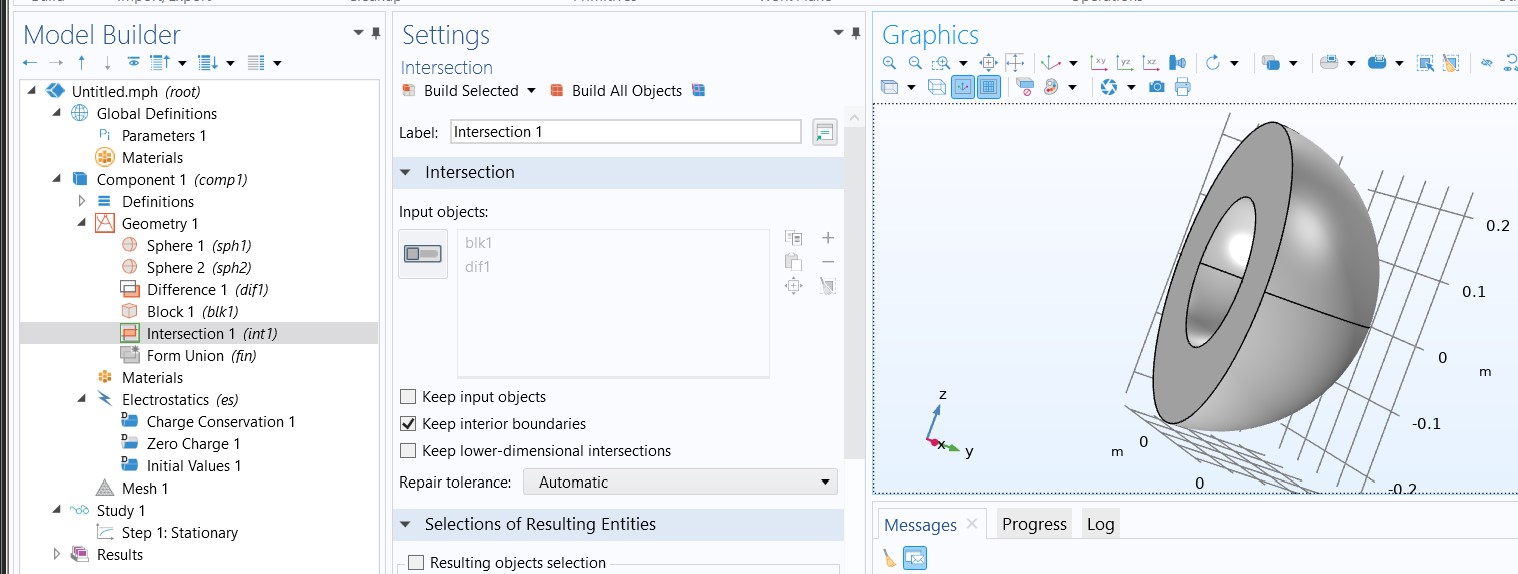

Hello @RobertKoslover thank you very much for your reply; I did the intersection between a rectangular block and the rest so that the result is half sphere; now do I need a new block to remove hal f of the half sphere (see image please)?

You're welcome. If you want (or need) to cut it in half again, go ahead. You can make as many blocks (or other shapes) and apply as many Boolean intersections (or other) operations as you wish.
