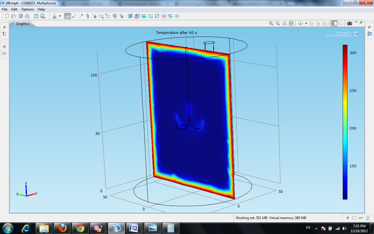

Posted: 1 decade ago Dec 10, 2012, 2:26 p.m. EST
Hello Sergei Yushanov,
Thanks for your helpful response
Yes exactly I want to make a model like “Hepatic Tumor Ablation” from Comsol model library with AC current
I did the steps as you told me, but the result of the temperature distribution were different from the case of the DC current, the photo of my result attached in this message and I also want to get the electric field distribution, please help me if you know what the problem in my model
thanks a lot
Hello Sergei Yushanov, Thanks for your helpful response Yes exactly I want to make a model like “Hepatic Tumor Ablation” from Comsol model library with AC current I did the steps as you told me, but the result of the temperature distribution were different from the case of the DC current, the photo of my result attached in this message and I also want to get the electric field distribution, please help me if you know what the problem in my model thanks a lot
Posted: 1 decade ago Dec 10, 2012, 5:10 p.m. EST
Basant,
It is hard to tell what is wrong without seeing your model but seems that heat source is not defined properly. Make sure that setting for heat source is correct. I did quick run of the model with AC current source and results are quite close to the DC case. Let me know if you still have issues with your model and I upload AC version of mph file for you.
Sergei

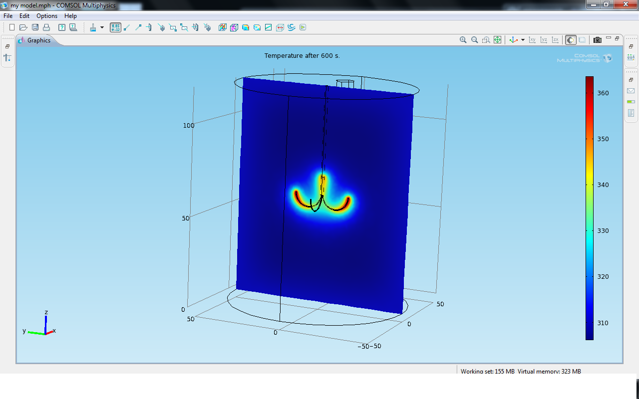

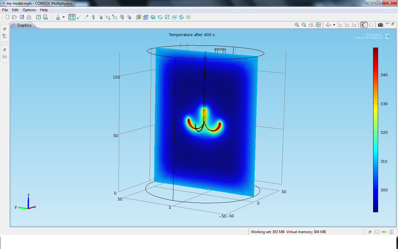

Hello Sergei,
I reviewed my model again; I did the steps exactly as in comsol dynamic help and the steps you told me for AC current, I found that when the time in “3D plot Group” sitting is greater than 400 sec the result of temperature distribution become close to the DC case.
This is the link for downloading my model, because I couldn’t attach my model in this message: www.4shared.com/file/xl7rUuQC/my_model.html
In "3D plot Group 2" the temperature distribution at 60 sec and in "3D plot Group 3" the temperature distribution at 600 sec you can see the difference between the two results.please help me if you know what the problem in my model.
thanks a lot

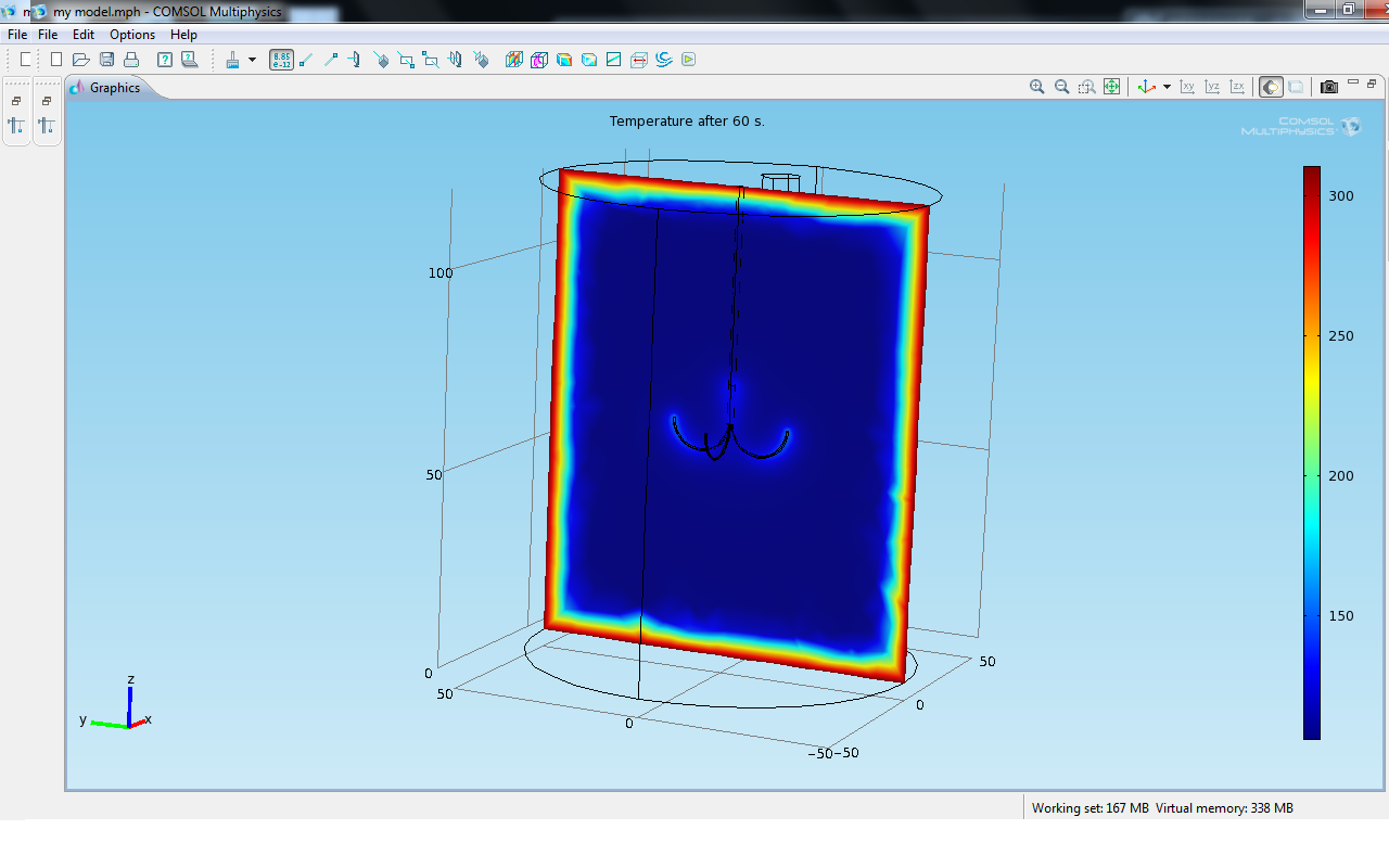

Posted: 1 decade ago Dec 18, 2012, 6:07 p.m. EST
Hello Sergei,
this is my model but without mesh and results, i wish you review it and especially the "study 1" setting. also there are screenshots of my results attached in this message, and note that the frequency of AC current is 500000 HZ
thanks a lot
Hello Sergei, this is my model but without mesh and results, i wish you review it and especially the "study 1" setting. also there are screenshots of my results attached in this message, and note that the frequency of AC current is 500000 HZ thanks a lot
Posted: 1 decade ago Dec 19, 2012, 9:22 a.m. EST
Basant,
The problem with your model was that you were still solving DC case (look at the equation – there is no frequency entering into Current Conservation law).
So, I did the following modification in your model:
1) Changed Electric Currents equation form to Frequency Domain;
2) Assigned (arbitrary) relative permittivity to all materials.
Modified model is attached.
Sergei
Basant, The problem with your model was that you were still solving DC case (look at the equation – there is no frequency entering into Current Conservation law). So, I did the following modification in your model: 1) Changed Electric Currents equation form to Frequency Domain; 2) Assigned (arbitrary) relative permittivity to all materials. Modified model is attached. Regards, Sergei
