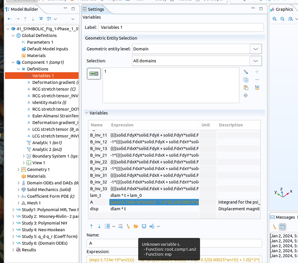

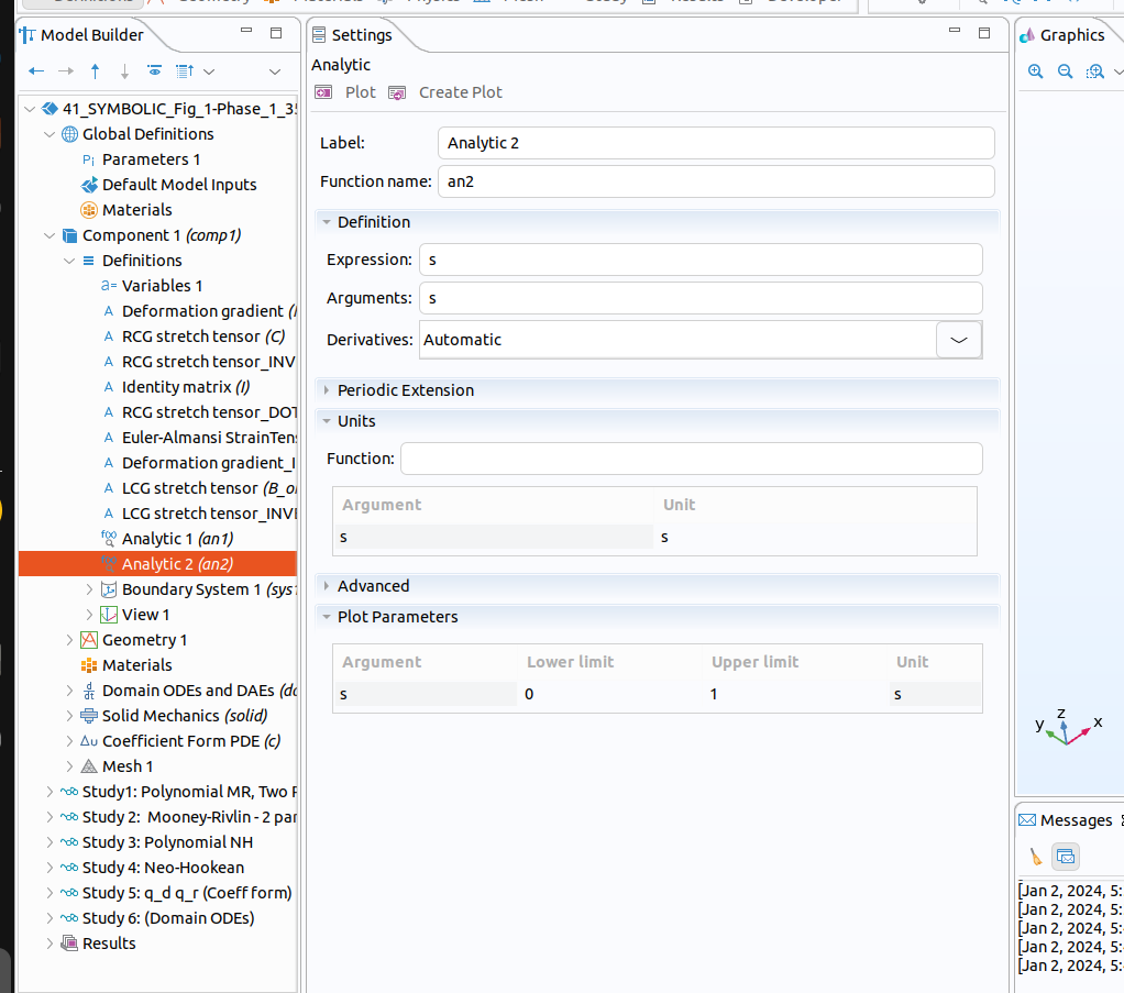

The arguments in the analytic functions are internal to them, used to define the function as a function of one or more variables. When calling the analytic function, you must do so with a variable that is defined in the model. In your case, you can call both an1
and an2
with t
, for example, which is the predefined variable for time in your model. On the other hand, s
is not known outside of an2
(but s1
and s2
would be, as surface parameterizations in 3D, for example; s
is predefined as an edge parameterization in 2D).

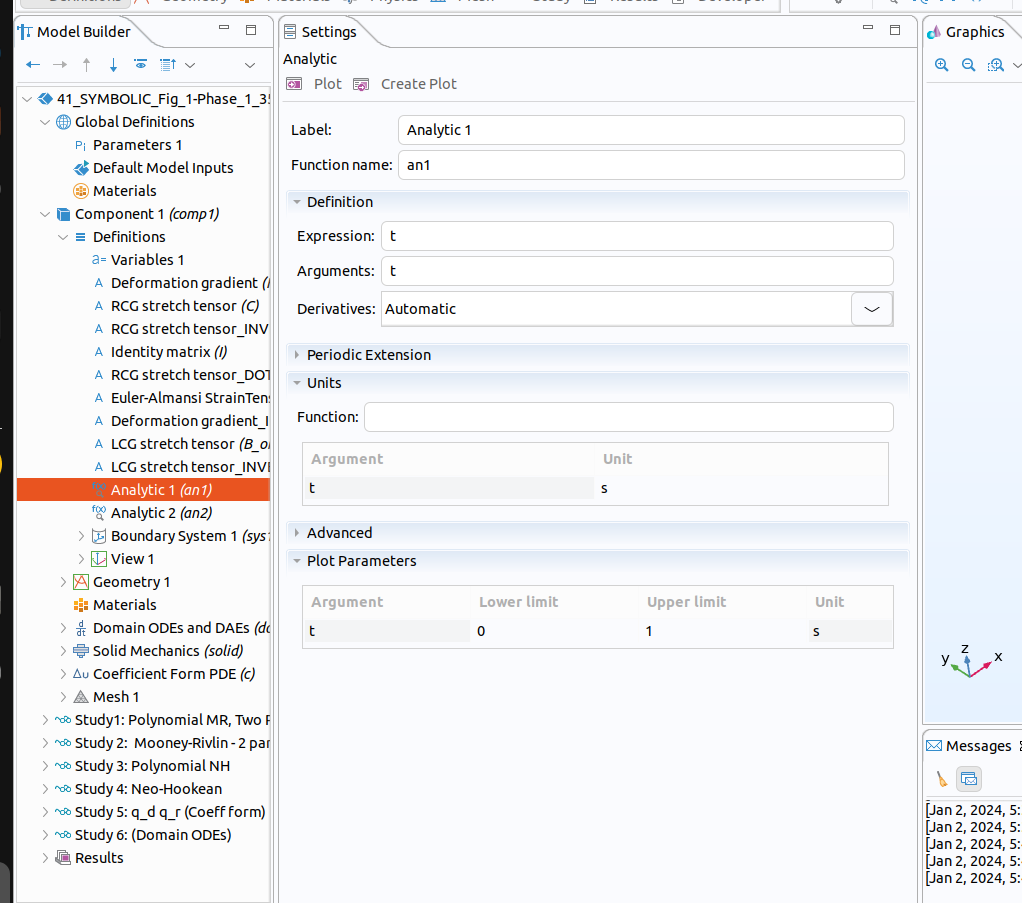

However, my issue is little different. In the 'variables' section you should find an variable called 'A'
where, A=(exp(-5.724e-10an2(s)) - 1.0)(0.5/(0.00025an2(s) + 1.0) - 0.5/(0.00025an1(t) + 1.0))^2(1.891e+5an1(t) - 3.782e+8(2.0/(0.00025an1(t) + 1.0) + (0.00025an1(t) + 1.0)^2)(0.00025an1(t) + 1.0)(8.333e-5an1(t) + 0.3333) + 7.564e+8) + (exp(-5.724e-10an2(s)) - 1.0)(0.5/(0.00025an2(s) + 1.0) - 0.5/(0.00025an1(t) + 1.0))^2(1.891e+5an1(t) - 3.782e+8(2.0/(0.00025an1(t) + 1.0) + (0.00025an1(t) + 1.0)^2)((0.00025an1(t) + 1.0)^2 + (0.00025an1(t) + 1.0)(8.333e-5an1(t) + 0.3333)) + 7.564e+8) + (exp(-5.724e-10an2(s)) - 1.0)(0.5/(0.00025an2(s) + 1.0) - 0.5/(0.00025an1(t) + 1.0))(0.5(0.00025an2(s) + 1.0)^2 - 0.5(0.00025an1(t) + 1.0)^2)(94550.0an1(t) + 6.051e+15/(an1(t) + 4000.0)^2 - (2.017e+15(2.0/(0.00025an1(t) + 1.0) + (0.00025an1(t) + 1.0)^2)(0.00025*an1(t) + 1.0))/(an1(t) + 4000.0)^2 + 3.782e+8)
where 't' varies from 0 to 1000 seconds( 1000 seconds is the total simulation time period). The time step (lets say dt) is 1 second.
's' on the other hand is a smaller time step which varies within the confinements of each time step. In other words,
when t=1 second , s varies from 0 to 1.
when t=2 second , s varies from 1 to 2.
when t=3 second , s varies from 2 to 3.
when t=800 second , s varies from 799 to 800.
when t=1000 second , s varies from 999 to 1000.
To acheive this i used two analytic functions "an1(t)" and "an2(s)" . But the expression for A(shown above) shows orange . This is because 'an2(s)' is not recognised. ( I am pretty sure an1(t) only seems to be recognised as perhaps Comsol perceives it to be time , which is right by the way).
Please help me with this, coz as i said earlier i am terribly stuck with this.

where, A=(exp(-5.724e-10*an2(s)) - 1.0)*(0.5/(0.00025*an2(s) + 1.0) - 0.5/(0.00025*an1(t) + 1.0))^2*(1.891e+5*an1(t) - 3.782e+8*(2.0/(0.00025*an1(t) + 1.0) + (0.00025*an1(t) + 1.0)^2)*(0.00025*an1(t) + 1.0)*(8.333e-5*an1(t) + 0.3333) + 7.564e+8) + (exp(-5.724e-10*an2(s)) - 1.0)*(0.5/(0.00025*an2(s) + 1.0) - 0.5/(0.00025*an1(t) + 1.0))^2*(1.891e+5*an1(t) - 3.782e+8*(2.0/(0.00025*an1(t) + 1.0) + (0.00025*an1(t) + 1.0)^2)*((0.00025*an1(t) + 1.0)^2 + (0.00025*an1(t) + 1.0)*(8.333e-5*an1(t) + 0.3333)) + 7.564e+8) + (exp(-5.724e-10*an2(s)) - 1.0)*(0.5/(0.00025*an2(s) + 1.0) - 0.5/(0.00025*an1(t) + 1.0))*(0.5*(0.00025*an2(s) + 1.0)^2 - 0.5*(0.00025*an1(t) + 1.0)^2)*(94550.0*an1(t) + 6.051e+15/(an1(t) + 4000.0)^2 - (2.017e+15*(2.0/(0.00025*an1(t) + 1.0) + (0.00025*an1(t) + 1.0)^2)*(0.00025*an1(t) + 1.0))/(an1(t) + 4000.0)^2 + 3.782e+8)
