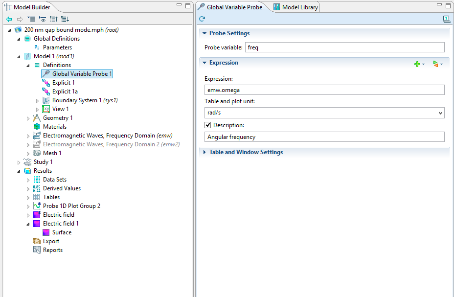

Thanks Ivar,
I understand the meaning of a complex eigenfrequency, my problem is simply that I ask for 1 eigenfrequency, yet comsol insists on giving me 2 eigenfrequencies, which is a problem for me. I don't know why comsol is doing this, but there is another solution to the problem. Let me phrase it this way:
Right now I have a probe that is set to probe the expression "emw.omega" (see attached screenshot), however, comsol solves for multiple eigenfrequencies, so it is finding several emw.omega values. If I probe emw.omega, it only probes the most recent emw.omega (ex. if I solve for 6 eigenfreq, it will output the 6th eigenfreq). In previous versions of comsol, if you wanted to probe say the 3rd eigenfrequency, you would simply probe "emw.omega(3)". Comsol 4.3a rejects this, so my question is, do you know how to tell the probe which solution to observe?
Thanks,
Chris

have you tries with the with(3,...) operator ? (you also have the at() for time series) there are many new operators in v4.3a, check the help on "operators". This might give you the solution. I do not know why you getr several modes, the best is to ask support for such things ;)

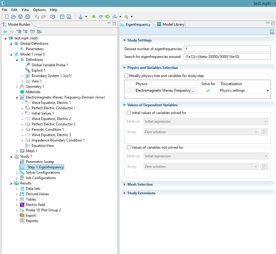

Hi, I meet a similar problem. In my optimization process, I would like to maximize one cavity mode's quality factor. But since there is a neighbor mode has higher quality factor. Comsol always optimizes the neighbor mode instead of the one I desired. I also tried to limit the number of eigenfrequency solved for(down to 1), to exclude that neighbor mode. But the situation is Comsol always give me solutions more than I want, making my optimization process failed. Could you tell me how you solved that problem later? Thank you.
Best,
Xingsheng

Comsol gives additional eigen-frequencies when there is no extra computational effort by the solver.
