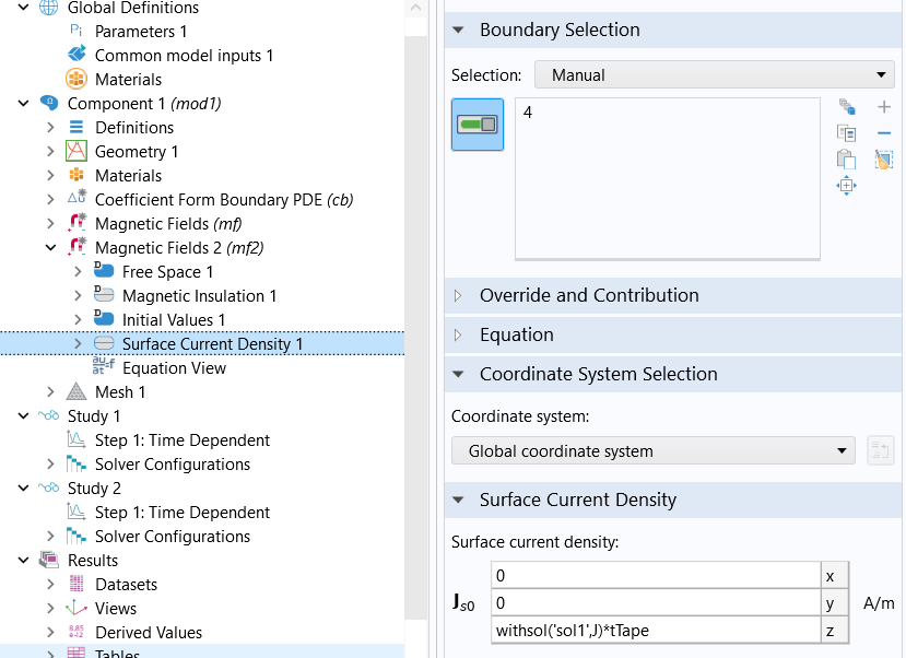

Thanks for the reply!
I had already seen these functions (setind and setval) but from what I understood, as you also reported, they allow you to define the withsol function only at certain moments of time or for certain values.
For example withsol('sol1',expr,setind(p,2)) refers to the second time instant, right?
What I would like to do is something like ('sol1',expr,setind(p,All_timestep)) where the values of p at each time step are taken into consideration.
Is it possible to do this and how should I write the withsol function?

Ah. If neither setind or setval work satisfactorily in this context, you may need to set up some kind of separate interpolation operation. (Note: According to the Help system, the use of setval in the withsol operation will support interpolation.) But I'm not sure if you might be having some kind of time-variable-naming issue. In principle, you could export the results (for J vs, time) of one run and then import those results into an interpolation function to use with your boundary condition in a subsequent run, but I suspect a less cumbersome approach exists. Perhaps another user, or Comsol employee, can suggest a more elegant solution?
