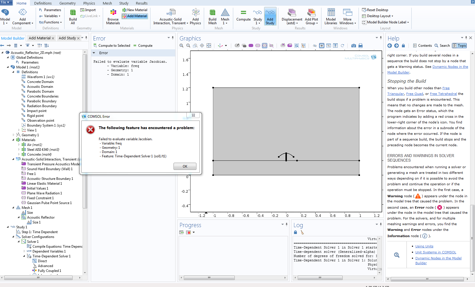

Hi, Sergei,
I think I have the pretty similar trouble as the one you solved. Could you take a quick look at the attached file and help me fix the problems.
Thanks in advance on your comment.
