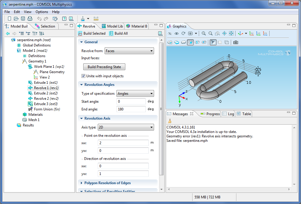

I would like to know how to create a serpentine heat exchanger inside a block of material (2 D and 3D)?

you can create a serpentine by extruding a face on a cylinder, alternated with a revolve operation (see screenshot).
Note that you can select a workplane or an existing face for these operators, a face is needed is this case.
Frank
Hello Nadjiba, you can create a serpentine by extruding a face on a cylinder, alternated with a revolve operation (see screenshot). Note that you can select a workplane or an existing face for these operators, a face is needed is this case. Best regards, Frank
