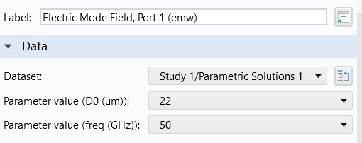

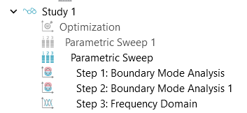

I am performing simulations on a CPW using the RF module Boundary Mode Analysis to find several propagating modes. I am running a Parametric Sweep for one geometry parameter and it seems that I cannot access all of the modes that the Boundary Mode Analysis finds. COMSOL only allows me to see one (I assume the one that finds last). I would like to know if anyone knows how to force COMSOL to store the results of all of the modes.
I uploaded some screenshots of the Study configuration I have. The parameter I am trying to sweep for is D0, when going to the results I cannot choose which mode to select.
