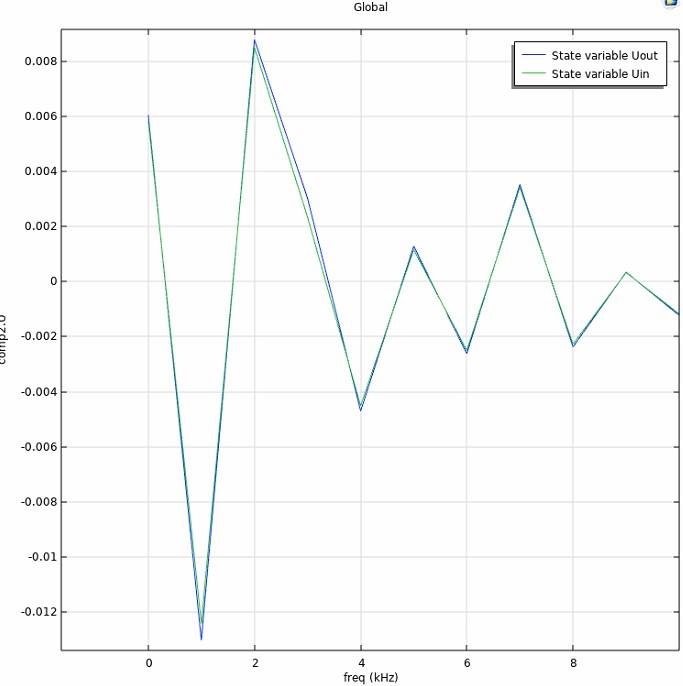

I'm simulating a nonlinear phononic crystal using time dependent study. My goal is to get the transmission loss for the structure and compare it with frequency domain study.
So I defined my study following the Loudspeaker Driver — Transient Analysis defining study 1 as time dependent and applying the sin displacement for a certain frequency and then collecting the input and output displacement history for last cycle. Then I defined another study as time dependent + fft to convert my results into frequency domain defining ODE & DAEs. I can successfully do this. However, I'm not clear how can we calculate the transmission loss out of that since I'm getting a different peaks for various frequencies.
also if I apply a range of frequencies as my source frequency, how can I integrate all of these results into a unique general transmission loss spectrum.
