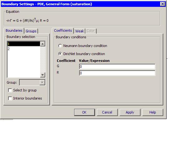

I want to know how to put a constant boundary like s=1 or s=0.2. with PDE mode
The PDE mode give me a Dirichlet and Neumann condition.
But it's a flux ?

The boundary conditions are of two types. (a) a value (Dirichlet) or slope (Neumann).
For your problem above, setting values would be using Dirichlet BCs.
To set these, in the Boundary mode, Boundary Settings, you'll see two items
listed in Boundary selections, one for each boundary. Select Item 1, corresponding
to the left boundary. The point on the line will be highlighted in red. In the
right panel under the Coefficients tab, select the Dirichlet boundary condition
radio button. At the top you'll see the equation template with the variables
and their context. You'll only need to be concerned with the R=0 part of this,
so leave G=0. R=0 is the equation that has to be satisfied on the boundary,
so for the left boundary if you want to set s=1, you would write it as s-1=0,
and in the entry for R you would then have s-1.
For the second boundary it's the same procedure, only for R you would enter s-0.2.
