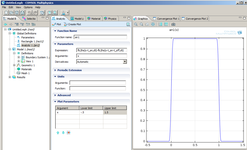

Hello Friends,
Am working on AC/DC Module and new to comsol. Am trying to define a rectangular pulse of 1200v with a duration of 1ns to an electrode and i wish your kind assistance for the same.
Thanks in advance.

Check the Definitions functions in V4, under "rect"angle You need todefine some "smoothings"
Hi Check the Definitions functions in V4, under "rect"angle You need todefine some "smoothings" -- Good luck Ivar

Muthuraman,
You can use predefined function for rectangular pulse. You can find this function under Definitions>Functions>Rectangle.
Alternatively, you can define rectangular pulse by yourself using built-in function flc2hs(x, scale), as shown in the attached picture.
Sergei
Muthuraman, You can use predefined function for rectangular pulse. You can find this function under Definitions>Functions>Rectangle. Alternatively, you can define rectangular pulse by yourself using built-in function flc2hs(x, scale), as shown in the attached picture. Regards, Sergei

Muthuraman,
Sergei
Thank you very much sir!!!
[QUOTE] Muthuraman, You can use predefined function for rectangular pulse. You can find this function under Definitions>Functions>Rectangle. Alternatively, you can define rectangular pulse by yourself using built-in function flc2hs(x, scale), as shown in the attached picture. Regards, Sergei [/QUOTE] Thank you very much sir!!!
