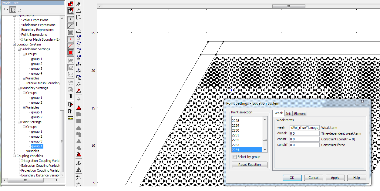

Hi all,
In 3.5a, within the RF module you can edit the weak form yourself by going to Equation System -> (Subdomain or Boundary or Point) Settings (see screenshot). Is this functionality still available somewhere in Comsol 4.3a?
--Will
