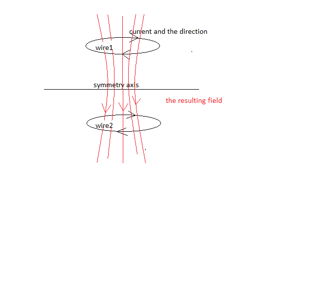

So, the description.
I have two identical wire loops placed above each other. The symmetry axis is in between them. The direction of the current on both wire loops is similar, so the resulting gradient of the magnetic field from one wire is amplified by the another wire. Thats the idea. The surrounding material in the region is air, and the material of the wires is copper.

Posted: 1 decade ago Feb 13, 2013, 9:02 a.m. EST
Mikhail,
a couple of comments to your model from a more physical point of view. Your drawing looks like a Helmholtz coil. So the two coils will not increase field gradients, they will decrease them. Helmholtz coils are known to produce particularly uniform fields. You will see that in the simulation when you compare a single coil to the two coil arrangement.
I don't see the purpose of the symmetry axis. Nothing in your setup is symmetrical regarding this axis. In an axisymmetric 2D model, as proposed by Ivar, the symmetry axis must extend through the centers of the coils.
If you need strong gradients you would rather define the currents in the two coils in opposite direction.
Cheers
Edgar
Mikhail, a couple of comments to your model from a more physical point of view. Your drawing looks like a Helmholtz coil. So the two coils will not increase field gradients, they will decrease them. Helmholtz coils are known to produce particularly uniform fields. You will see that in the simulation when you compare a single coil to the two coil arrangement. I don't see the purpose of the symmetry axis. Nothing in your setup is symmetrical regarding this axis. In an axisymmetric 2D model, as proposed by Ivar, the symmetry axis must extend through the centers of the coils. If you need strong gradients you would rather define the currents in the two coils in opposite direction. Cheers Edgar

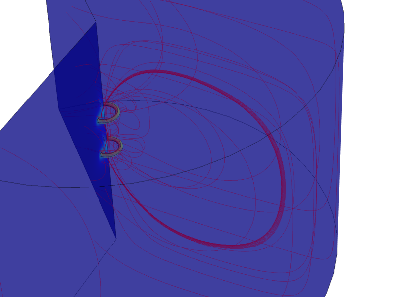

Posted: 1 decade ago Feb 14, 2013, 6:24 a.m. EST
Hello again, thank to you all, I've managed to do exactly what I wanted.
I've attached a screenshot from the 3D view of the coils.
Now I am going to add more parallel coils along the z-axis. This is going to be a bit tougher, since I can't use the symmetry. So I guess I should drawing the coils in 3D.
Hello again, thank to you all, I've managed to do exactly what I wanted. I've attached a screenshot from the 3D view of the coils. Now I am going to add more parallel coils along the z-axis. This is going to be a bit tougher, since I can't use the symmetry. So I guess I should drawing the coils in 3D.
