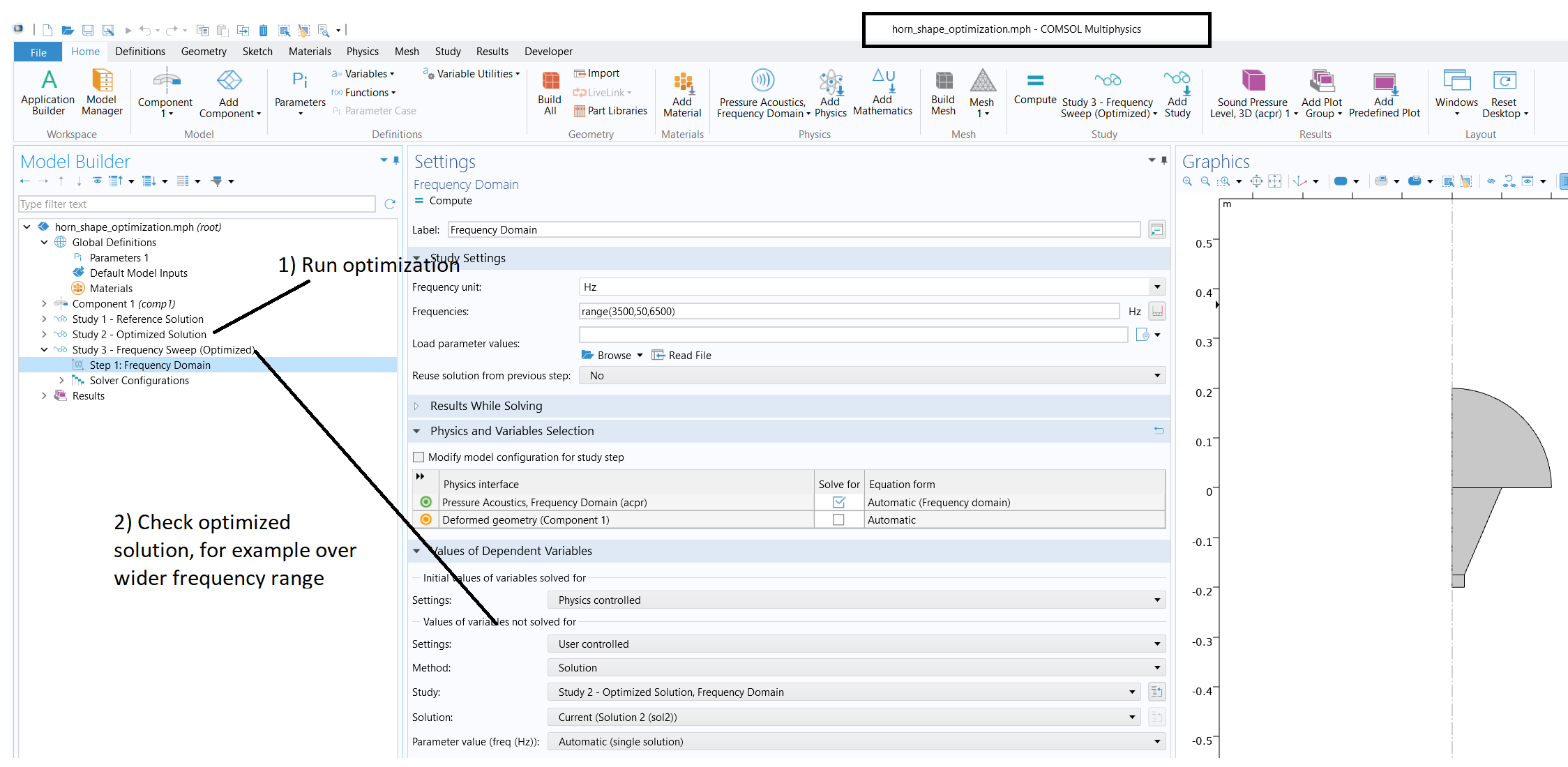

hello. I studied in the frequency domain using the shape optimization module and obtained optimized geometry. I want to conduct another study using this optimized geometry, but I don't know where the geometry is stored or how to utilize this geometry. Can you give me some advice?

You can see an example here from the acoustics module. The principle should be the same.
