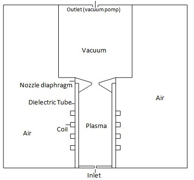

*** first question: I try to simulate the device using the PLASMA MODULE (inductively coupled plasma) and LAMINAR FLOW in a vacuum (10 millitorr). The problem is that when I run the solver, had very long time solver works! my time range of Frequency-Transient solver is (1e-8) to (1e-3). I look at the log and convergence plot, the process starts from the time (1e-013) and up to the about (1e-7) the process goes quickly, but then stays on for a long time at this time and several hours process work without promotion. wanted to know what could be the problem?
*** second question: how can simulate a high vacuum but with laminar flow? the point is that device are in a high vacuum (1e-5 torr) and enters into device argon gas (0.1mg/s) and by a high frequency, plasma is formed. The problem is that when I use the laminar flow, this module does not respond less than (10 millitorr) and when I use the Free Molecular Flow, there is no (inlet) options. how to use this two module together ( laminar flow and Free Molecular Flow ), or maybe have separate modules appropriate?
