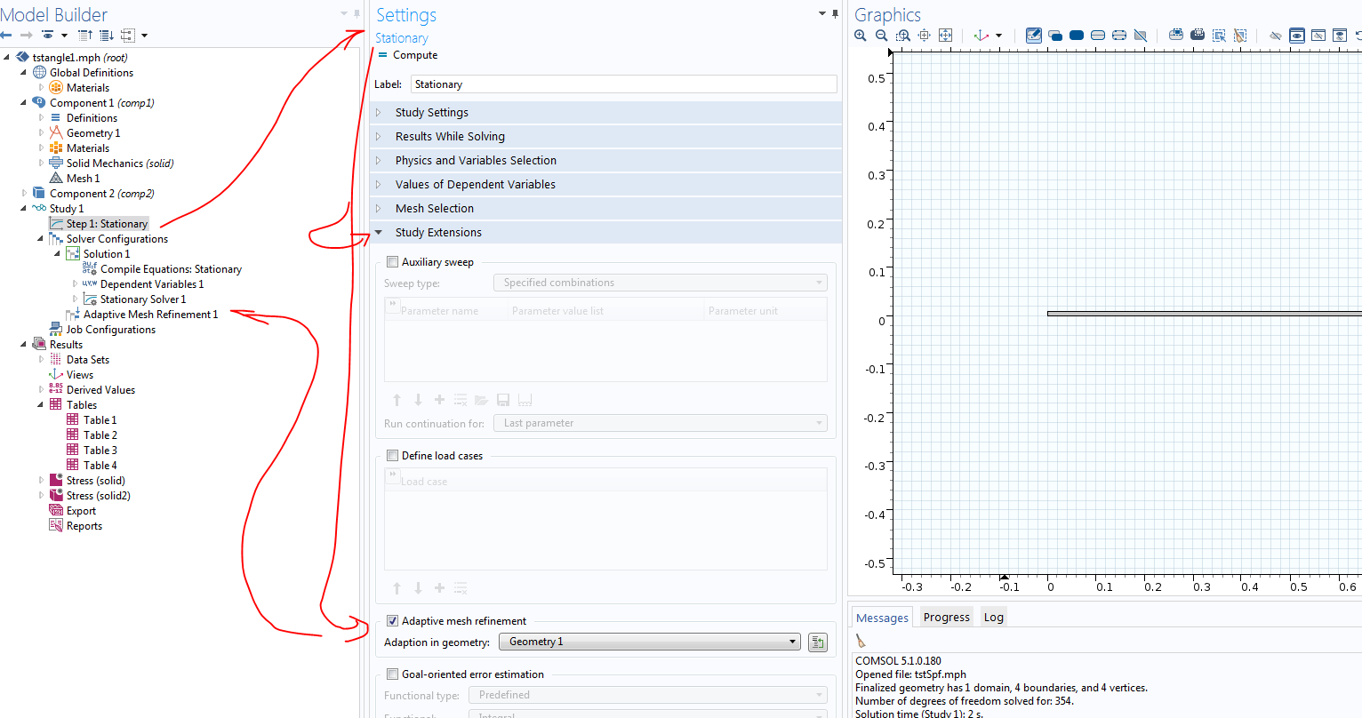

Posted: 10 years ago Aug 28, 2015, 1:47 a.m. EDT
its all in the solver node, under "Study Extensions"
Check the corresponding doc, it still needs some tweaking to adapt to your model, but start with the default values
Hi its all in the solver node, under "Study Extensions" Check the corresponding doc, it still needs some tweaking to adapt to your model, but start with the default values -- Good luck Ivar
Posted: 10 years ago Aug 28, 2015, 10:42 a.m. EDT
Hello Ivar ;
The best thing in this forum is your fast response to our questions. appreciated .
This is fine to refine my mesh more and more, but how can I draw the linear relationship base on mesh refinement with errors. Can I export these data?
I am working on 2D model now. How can I sure that the same refining will produce if I use 3D model?
