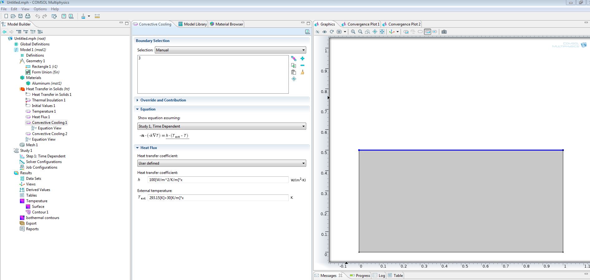

but that is what the convective BC is doing anyhow, If you put 293[K] in the reference temperature it is a scalar, constant value, but if you have efined a field my_T(x,y,z) and use your my_T in the reference temperature entry, and your BC defines a maping to a given (x,y,z) then you are changing the reference temeperautre depending on your (x,y,z,t) location (t is option as you might not be solving for t
This is COMSOL's "implicit" notation, it's often confusing, but any scalar entry in a BC field, can also be a field depending on the (x,y,z) (and t) of the BC area

Thanks for the response. I think I understand what you're saying as, the 'T' in the BC equation 'qo=h.(Text-T)' is automatically the surface temperatrue computed by COMSOL. However, the convection coefficient 'h' is currently a constant. If I want to make it a function of the surface and room temperatures, or h=h(Text,T), how do I do that? First, I need to define a surface temperature, correct? I am trying to do so by adding a surface probe. Is that the way to do it, or is there an easier way?

but you can replace "h" by a function or an equation of your own see example 4.3a below
