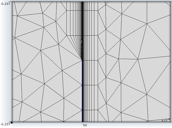

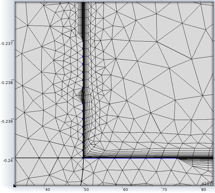

boundary layer meshing ?
why is the boundary meshing interrupted in the corner of 2 edges?
(attached pictures)
These are the limits of my plasma reactor. The point where my electrical feedthrough is, ceramic/metal joint.
The point where all happens?).
So why is there the mesh not like a bit further away, where the boundary meshing is on both side of the edges?
in 3.5, I could prevent comsol from meshing inactiv domains.. I am doing something wrong (the inside of metals do not bother me..)

Posted: 1 decade ago Mar 29, 2013, 7:10 a.m. EDT
strange, it could be from some BC that turns them, off, but if the boundaries are all in the list of the boundary mesh definition they should be meshed. Probably only Support might be really able to tell here ;)
Hi strange, it could be from some BC that turns them, off, but if the boundaries are all in the list of the boundary mesh definition they should be meshed. Probably only Support might be really able to tell here ;) -- Good luck Ivar
