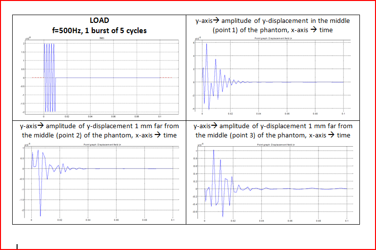

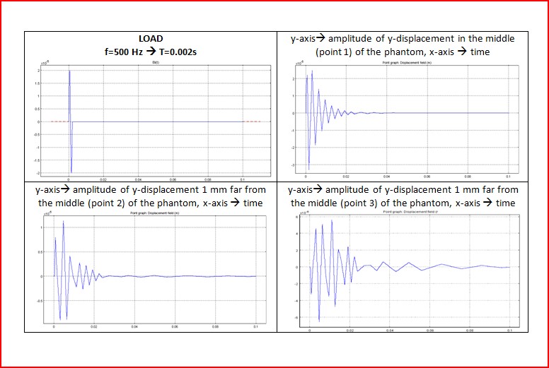

I apply my sine wave as a fixed displacement as follow: A[m]*sin(2*Pi*f[1/s]*t). I want to simulate a rigid body vibrating in touch with the thin layer.
If I apply only one pulse (see the attached figure called one_pulse) I can see this pulse propagating inside the thin layer (I have ploted the y-displacement in function of time for different distances from the source). If I apply a burst of 5 cycles (I have changed only the number of pulses) I can't see these 5 cycles propagating inside the medium. It looks like a bad sampling (see the attached figure burst_5cycles).
For both simulations I have used a time step of 1/(20*freq) and a maximum element size of wavelength/20.
Many thanks.
Ramona
Hi Nadon, thanks for your suggestions. I apply my sine wave as a fixed displacement as follow: A[m]*sin(2*Pi*f[1/s]*t). I want to simulate a rigid body vibrating in touch with the thin layer. If I apply only one pulse (see the attached figure called one_pulse) I can see this pulse propagating inside the thin layer (I have ploted the y-displacement in function of time for different distances from the source). If I apply a burst of 5 cycles (I have changed only the number of pulses) I can't see these 5 cycles propagating inside the medium. It looks like a bad sampling (see the attached figure burst_5cycles). For both simulations I have used a time step of 1/(20*freq) and a maximum element size of wavelength/20. Many thanks. Ramona
