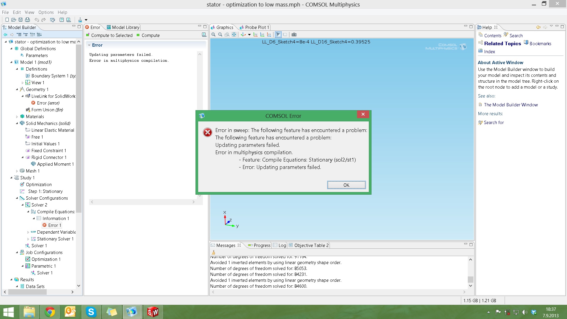

Using optimisation (under the study node) I managed to define the boundary parameters and the objective function equations for the model's mass. I also defined I want a minimization type and made a sum of both objective functions.
When I compute the analysis i get and error in multiphysics compilation. I believe this could be solved using other mesh types, but my problem can also be seen in solidworks, where the model is updated and does not look as it was expected and there is also an error visible in comsol livelink (Updating parameters failed.). The lower and upper boundaries have been exceeeded as it seems and 3/4 of the model are missing.
If anyone has an idea how to solve this please provide me with some guidance. I am pretty much new with Comosl and have searched the commutnity, guides, tutorials, conference proceedings but haven't really found some similair cases.

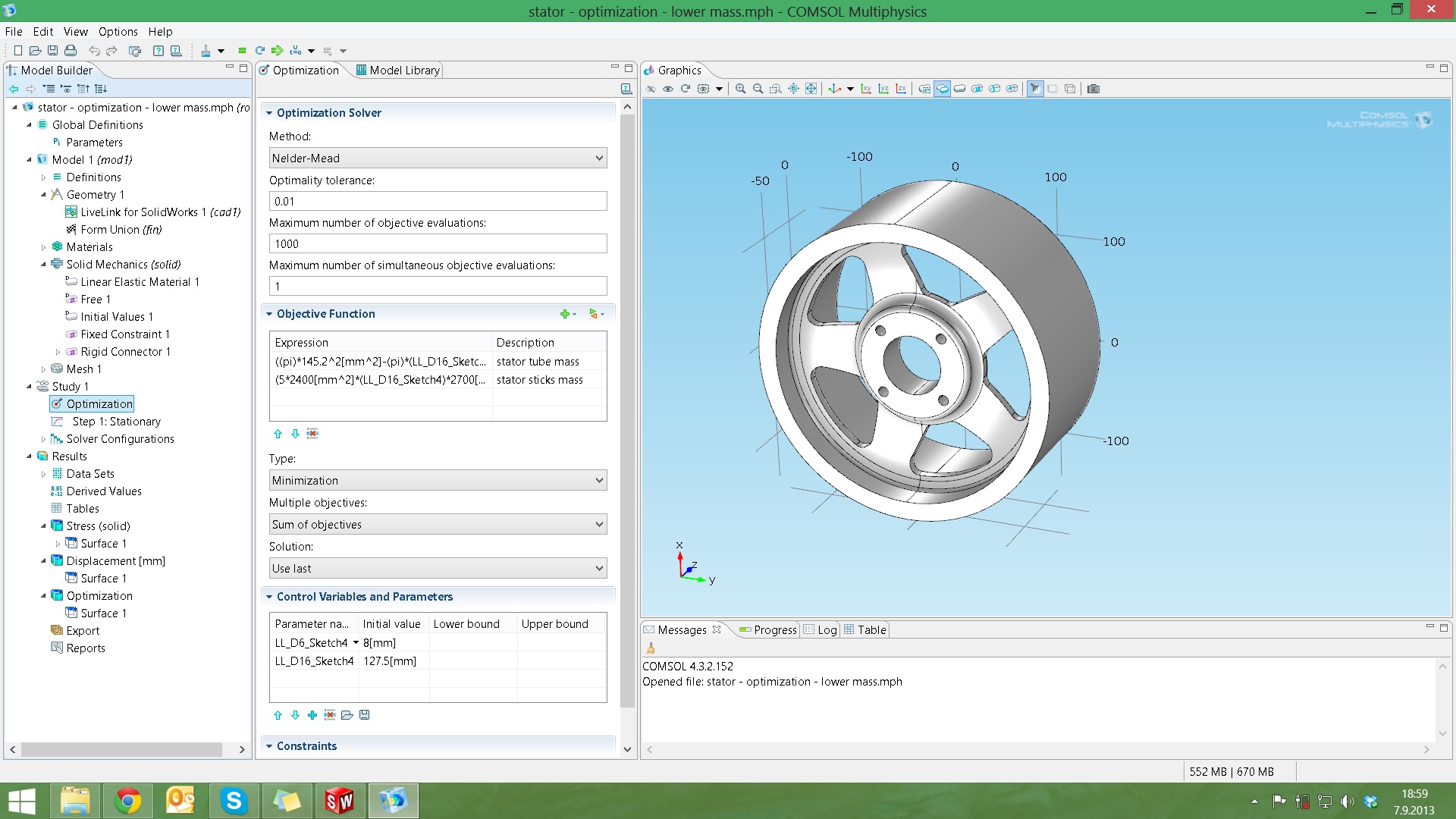

I was able to determine the cause of the fault. I managed to find an older post from Ivar, expalining that it is wise to make a parameter sweep before doing the actual optimisation in order to see with which boundary conditions the system will converge...
In addition I have made a simple optimisation, but was not yet able to add a proper constraint to my analysis.
The aim of my analysis is to reduce the model mass, while having the displacement inside my desired values. The first part is working fine, but as I am not able to input a constraint the analysis finishes with the minimum model mass and this reduction in material is not a function of stress or dispalcement, which is my final goal.
Attached is a picture of my design tree.
I am sure there is prety simple solution to this, just I am not able to determine it. Where and what to input to get a constraint in deformation.
Please provide me with some information...
