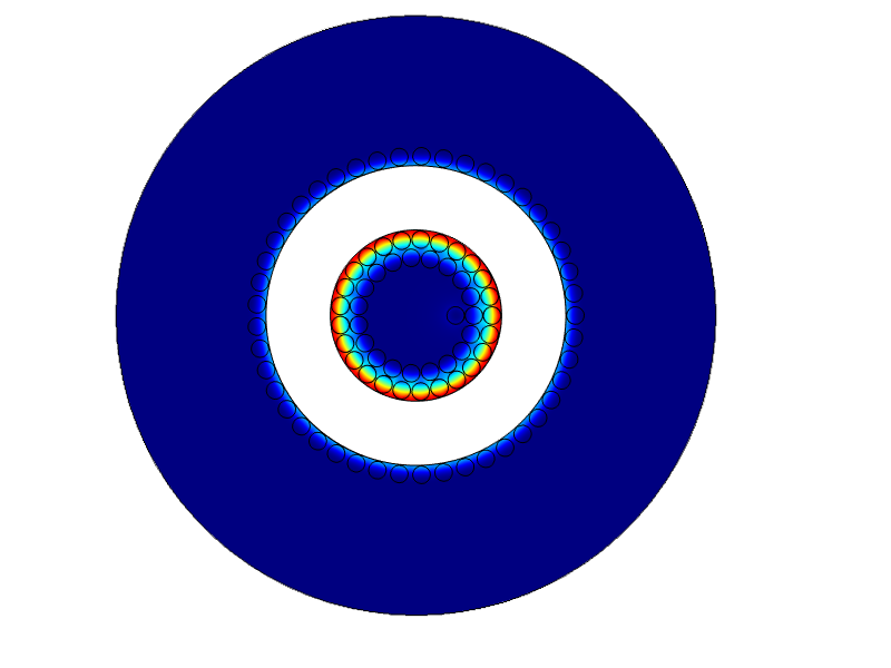

I'm trying to get energy in the core from a model with implementation of HB curve (non ideal magnetic material), but I don't get magnetic energy inside the core. As seen on other topics a second Ampere's Law with HB is added for the magnetic material.
It's then not possible to compute the inductance value from magnetic energy as there is no result in the core.
