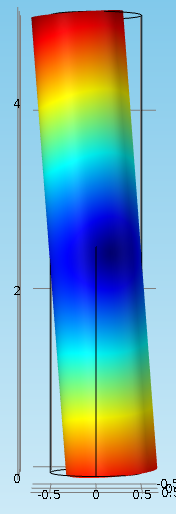

Posted: 1 decade ago Jun 22, 2014, 3:37 a.m. EDT
HI Eric
Thanks for your explanations.I went through all and now I got the point. I want to apply it for bending cylinder( whose axis is along Z axis ) by applying a moment on top and bottom surfaces of the cylinder along Y-axis
1- definition of moment
M=integral(y*pzd2.sz)
2- Global equations
Tau=M -100
3- Boundary loads
Fx=Tau
But Its not giving bending of the ncylinder. I have attached the picture of the displacements a
Thanks,
H.
HI Eric Thanks for your explanations.I went through all and now I got the point. I want to apply it for bending cylinder( whose axis is along Z axis ) by applying a moment on top and bottom surfaces of the cylinder along Y-axis -------------------------------------------- 1- definition of moment M=integral(y*pzd2.sz) 2- Global equations Tau=M -100 3- Boundary loads Fx=Tau But Its not giving bending of the ncylinder. I have attached the picture of the displacements a Thanks, H.
