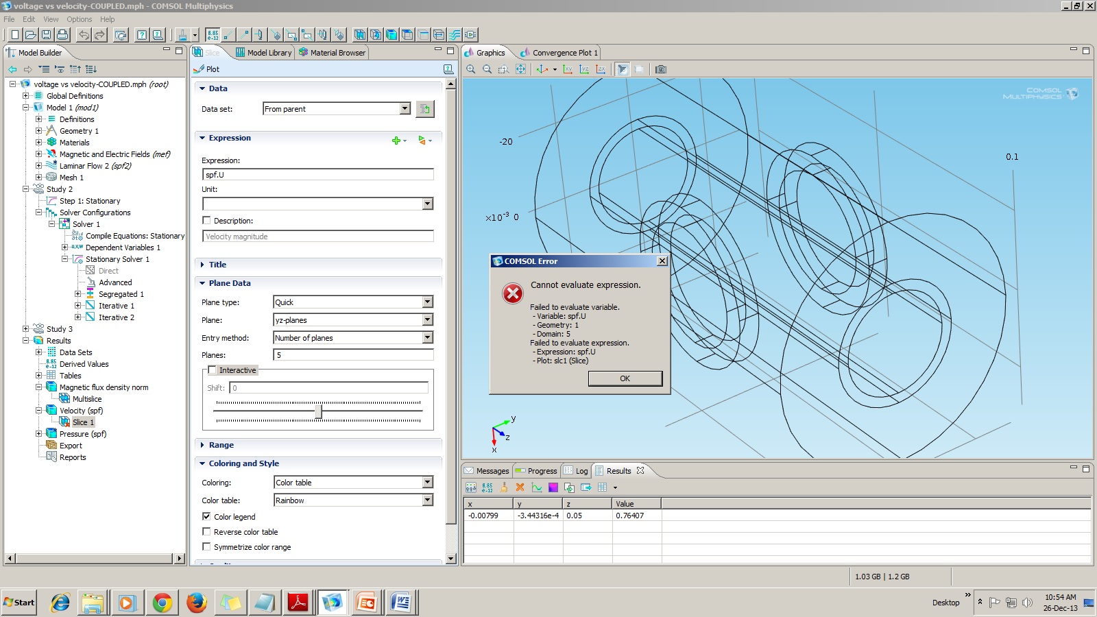

This is N.Kumar from IIT MADRAS, I was trying to get the 2d plot for the electromagnetic flow meter.in this regard i was facing the preoblem as,
failed to evaluate variable:
variable:spf.U
Geometry:1
domain:1
Failed to evaluatr expression:
expression:spf.U
plot slc(1) slice.

Hello Kumar,
Your laminar flow has identifier spf2, therefore you should plot spf2.U. This should fix the error.
Frank
Hello Kumar, Your laminar flow has identifier spf2, therefore you should plot spf2.U. This should fix the error. Best regards, Frank
