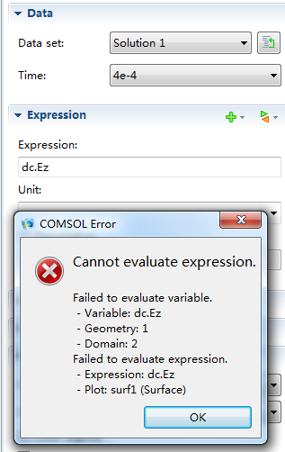

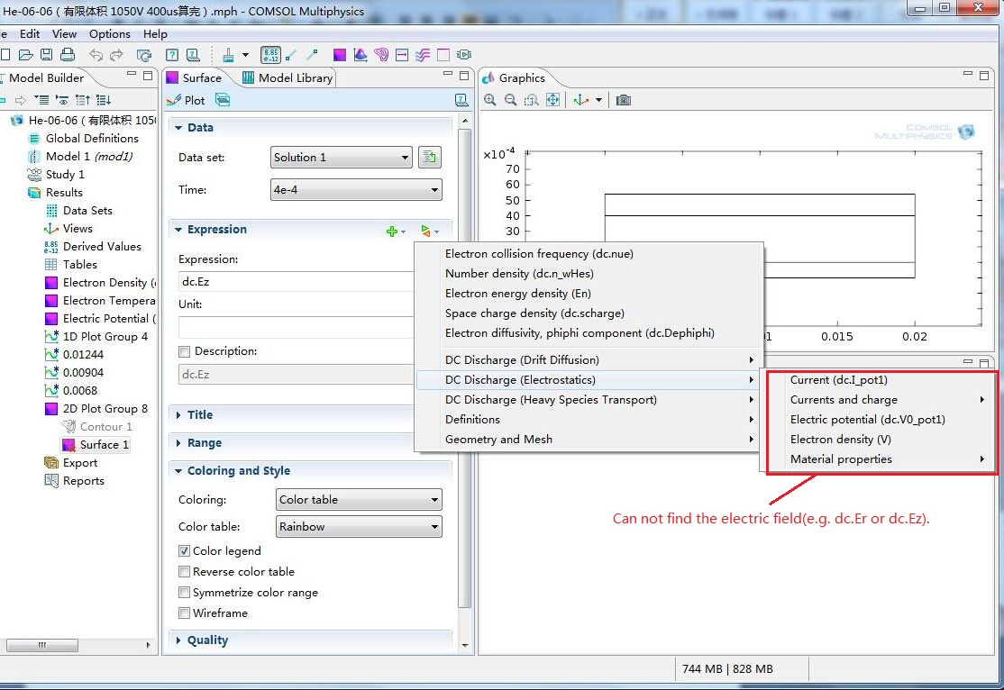

Posted:
9 years ago
Jan 21, 2015, 9:16 p.m. EST
Dear Mr. Gritter,
My model is a 2D DBD with planar electrodes. I try to plot the Electric field again, But under the expression selections, I still can't find it. So I type dc.Ez in the expression, it come out a error: Can not evaluate expression.(see the Attach File)
Hoping for your replying.
Zhiming Huang
Dear Mr. Gritter,
Zhiming Huang
Luke Gritter
Certified Consultant
Posted:
9 years ago
Jan 22, 2015, 9:22 a.m. EST
If you have a 2D model, there is no electric field in the z-direction. The electric field components are dc.Ex and dc.Ey.
Luke Gritter
AltaSim Technologies
Luke Gritter
Posted:
9 years ago
Jan 22, 2015, 9:25 a.m. EST
Oh, it is 2D axisymmetric model.
Luke Gritter
Posted:
9 years ago
Jan 22, 2015, 9:35 a.m. EST
Which version of COMSOL are you using? Is domain 2 a plasma or dielectric domain?
Luke Gritter
Luke Gritter
Posted:
9 years ago
Jan 22, 2015, 9:39 a.m. EST
I use the 4.3a, and the domain 2(the middle one) is plasma.
Luke Gritter
Posted:
9 years ago
Jan 22, 2015, 10:07 a.m. EST
The implementation is somewhat different in the older versions, and I'm not sure whether there is a way to postprocess the electric field in version 4.3a. In versions 4.4 and 5.0, at least, the electric field can be visualized using the variables mentioned above.
Luke Gritter
Luke Gritter
