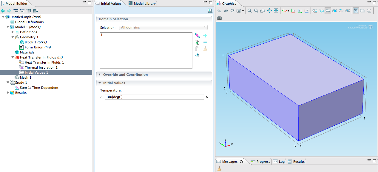

If your environment has 100°C as initial temperature you have to set it in "Initial Value" in the heat transfer module.
See the image attached.
Have a good work!

Hi, If your environment has 100°C as initial temperature you have to set it in "Initial Value" in the heat transfer module. See the image attached. Have a good work! -- Marino Miccio Chemical Engineer http://marinomiccio.wix.com/home
