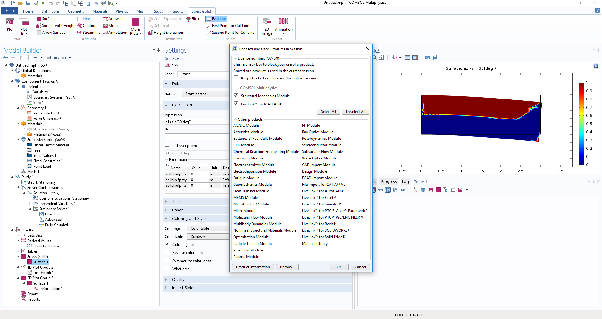

But no "Plasticity" node appears when I right click on "linear elastic material node".
I have only solid mechanics module. Is this the reason? Do I have to buy other modules if I want to simulate plastic behaviour?
Thanks
Hi But no "Plasticity" node appears when I right click on "linear elastic material node". I have only solid mechanics module. Is this the reason? Do I have to buy other modules if I want to simulate plastic behaviour? Thanks

Hello Farough,
It sounds like you have only the structural mechanics capabilities of the core COMSOL Multiphysics, not the Structural Mechanics Module.
You can check on that under File > Used and Licensed Products.

Posted: 8 years ago May 19, 2017, 1:03 p.m. EDT
Jeff
Thanks for your message.
I believe I "have" the module, please see the photo attached.
Jeff Thanks for your message. I believe I "have" the module, please see the photo attached.

Hello Farough,
You are right. What I forgot is that for the Plasticity node to appear you need not only the Structural Mechanics Module but also either one of the Geomechanics Module or Nonlinear Structural Materials Module (See www.comsol.com/products/specifications/structural-mechanics/).
Sorry for the confusion.
