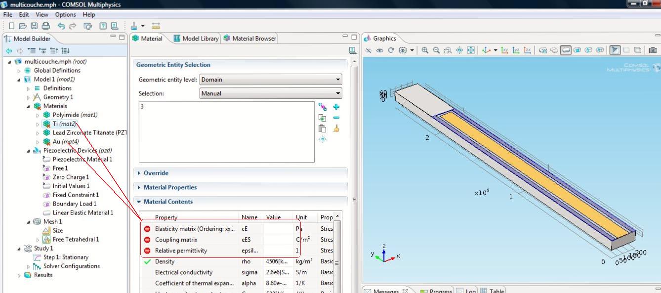

hi Ankur Saxena, i'm designing a piezoelectric cantiliver , with different material and i got problem in material property, in coupling matrix and Elasticity and permittivity (in th image) , please please please can yous help me.
