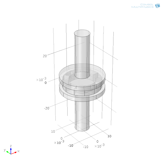

-> contactBolts_ringVarCondu.png shows the contact disks and bolts. A Normal Current BC is applied to the top bolt and a Ground BC is applied to the lower bolt. In between is a segmented ring. The conductivity of the segments will vary over time in that way that the resulting current path will describe a circle between the two contact disks.

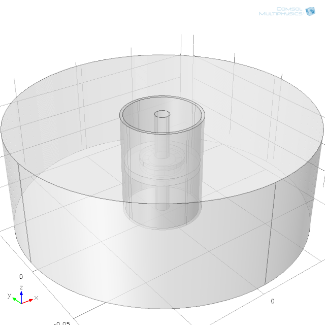

-> complete.png shows the whole model with a cylinder jacket around the contact geometry and an surrounding air domain where the outside magnetic field will be measured.

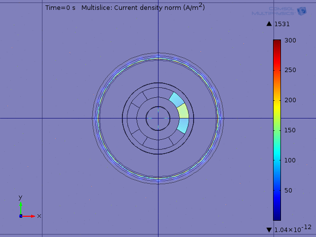

-> eddyCurrentsCylJacket.gif this top view shows the induced eddy currents in the conductive cylinder jacket which are one part i'am interested of.
