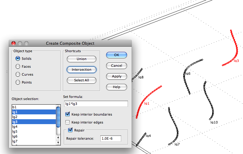

I found something odd with the 'intersection' operation in COMSOL. Yesterday I accidently picked up two geometry objects, that had no intersection at all, and then I clicked the 'intersection' button in draw toolbar. I thought a dialog box would appear and tell me 'Operation resulted in empty geometry object' just like before. But NO. It ended up deleting one object with no error, meaning the intersection operation resulted the other object left. I was 100% sure those two geometry objects had absolutely no intersection. And then I tried different set of two objects with no intersection. Some ended up empty, some still produced no error message and had one object left.

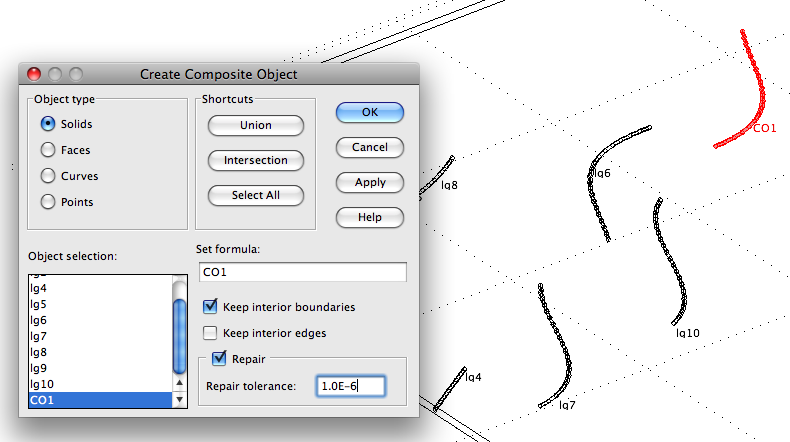

Thank you for your reply. I just double checked, and I am now pretty sure that I did click the 'intersection', not 'difference'. Even I do the intersection operation by hit the (+/-*) as you suggested, the same thing happens.
I attached two images to show how that happened.

Well I tried before in 2D, did it again in 3D on a PC with V3.5a:
Intersection: BLK1*BLK2 when they do not intersect gives an error message resulting in empty geometry
when the volumes intersect I get the intersection as expected
Difference: BLK1-BLK2 when they do not intersect leaves only BLK1 (BLK2 dissapears)
when they intersect I get the difference (but the rest dissapears in this case BLK2 as above)
For me this is very logical.
From your images, are you using a mac ? or unix ?
there might be an issue there, or on the keyboard mapping ?
I would propoe to pass by COMSOL support, by documenting carefully (images plus fomulas, even screen snip/dumps of the fomulas, that helps. Do not forget to give them version and OS
Good Luck

The OS question is a really good call. I was using Mac, but I just tried the same operation on the same geometry objects in Windows, no problem at all. And yes I am using V3.5a
