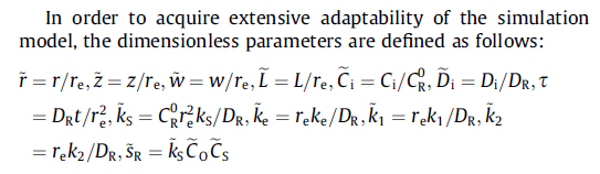

I think it is because i set the diffusion coefficient to small, so i change the unit of my pde,I change all coefficients' unit to 1(you can see it in picture),but in comsol the geometry and physics still have the unit such as [m] and so on, my question is whether it will influence the solution of the pde,will i get the solution i want by inverse transformation.
thanks a lot!

I have a similar problem.
I am trying to implement a MATLAB script to explore a set parameter space in a fluid problem.
The issue is that I am working with dimensionless equations and numbers.
I know how to implement this with the COMSOL desktop, but I've no idea how to set the unit system to dimensionless in the model created with MATLAB. I also seem to be unable to find it in the manuals provided for Livelink implementation.

Posted: 1 decade ago Dec 17, 2014, 6:27 a.m. EST
In the uppermost level, in the end of the screen, select Unit System to None.
