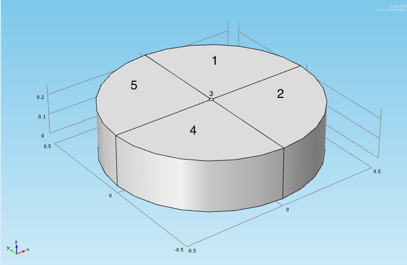

So I tried to build the COMSOL model which was two concentric cylinders (the one inside was modeled as hollow).
I set the material of the outside cylinder as air and the one on the inside as my compound 2-nonenal.
I gave the initial values as 0 for the outside cylinder and c for the inside one (although I have never defined a c.. I'm unsure about this particular boundary condition).
For the convection and diffusion tab, I did a user-defined diffusion coefficient (D which is what I set for the 2-nonenal material).
I used a normal mesh size and got this error:
Failed to evaluate variable Jacobian.
- Variable: D
- Geometry: 1
- Domain: 1
I'm unsure what this error means? And also, I'm unsure if I defined my initial condition correctly?
So I tried to build the COMSOL model which was two concentric cylinders (the one inside was modeled as hollow). I set the material of the outside cylinder as air and the one on the inside as my compound 2-nonenal. I gave the initial values as 0 for the outside cylinder and c for the inside one (although I have never defined a c.. I'm unsure about this particular boundary condition). For the convection and diffusion tab, I did a user-defined diffusion coefficient (D which is what I set for the 2-nonenal material). I used a normal mesh size and got this error: Failed to evaluate variable Jacobian. - Variable: D - Geometry: 1 - Domain: 1 I'm unsure what this error means? And also, I'm unsure if I defined my initial condition correctly?

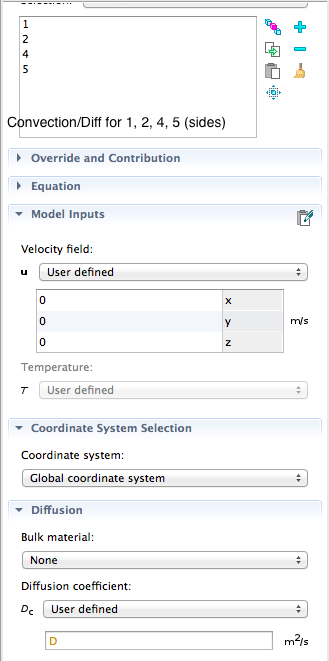

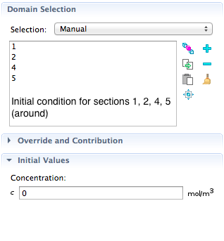

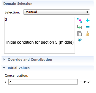

Here are some screenshots of my model -- maybe it'll be easier to see my error if you look at them? I have labeled what each screenshot is as text on the picture itself.
After running this model with a normal mesh, I still get the following error:
- Variable: D
- Geometry: 1
- Domain: 1 2 4 5
Here are some screenshots of my model -- maybe it'll be easier to see my error if you look at them? I have labeled what each screenshot is as text on the picture itself. After running this model with a normal mesh, I still get the following error: Failed to evaluate variable Jacobian. - Variable: D - Geometry: 1 - Domain: 1 2 4 5

I think you need to extend the bigger cylinder in the positive and negative z-direction because the nonanal can also diffuse in that direction.
Also, there will be no diffusion inside the arm itself right?
You have not defined D and c. You can define them by adding a 'parameters' node to 'global definitions', and putting them their with the number that belongs to them.
I think you need to extend the bigger cylinder in the positive and negative z-direction because the nonanal can also diffuse in that direction. Also, there will be no diffusion inside the arm itself right? You have not defined D and c. You can define them by adding a 'parameters' node to 'global definitions', and putting them their with the number that belongs to them.
