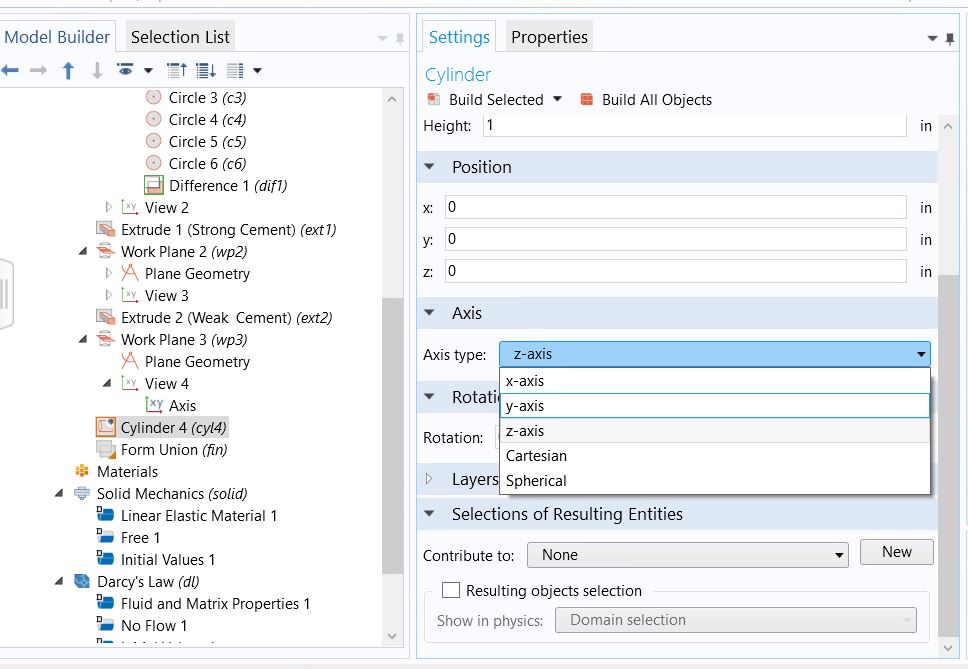

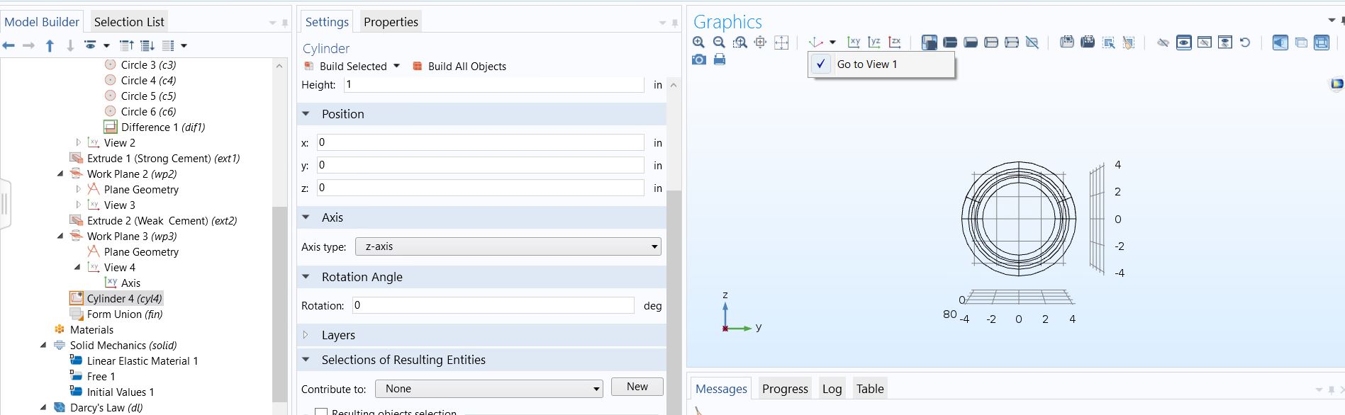

Posted: 8 years ago Jul 11, 2017, 8:44 p.m. EDT
Hello Ivar:
I have tried to define a "local coordinate system" with x- axis rotated by 30 degrees in a work plane (please see the attached screenshot) . I intend to create a cylinder in this local coordinate system. Unfortunately, I am unable to locate an option to select this local coordinate system in the "axis type" drop-down menu.
I tried to change the "View"; however, there is only one option available here, which is the default view available with COMSOL (please see the attached screenshot).
I am not sure what I am missing here and I would appreciate if you could suggest a way to create a geometry using the local coordinate systems as I have defined in my problem.
Thanks,
Shashank
Hello Ivar: I have tried to define a "local coordinate system" with x- axis rotated by 30 degrees in a work plane (please see the attached screenshot) . I intend to create a cylinder in this local coordinate system. Unfortunately, I am unable to locate an option to select this local coordinate system in the "axis type" drop-down menu. I tried to change the "View"; however, there is only one option available here, which is the default view available with COMSOL (please see the attached screenshot). I am not sure what I am missing here and I would appreciate if you could suggest a way to create a geometry using the local coordinate systems as I have defined in my problem. Thanks, Shashank
Magnus Ringh COMSOL Employee
Posted: 8 years ago Jul 12, 2017, 3:53 a.m. EDT
Hello Shashank,
This question is not related to views.
In the current version of COMSOL Multiphysics (5.3), you can choose the work plane as the coordinate system in the Settings window for a Cylinder feature.
In earlier version, you can create a cylinder in the work plane's local coordinate system by first adding a circle in the Plane Geometry under the Work Plane. Then, from the Work Plane's context menu, choose Extrude to extrude the circle into a cylinder.
Magnus Ringh, COMSOL
Hello Shashank, This question is not related to views. In the current version of COMSOL Multiphysics (5.3), you can choose the work plane as the coordinate system in the Settings window for a Cylinder feature. In earlier version, you can create a cylinder in the work plane's local coordinate system by first adding a circle in the Plane Geometry under the Work Plane. Then, from the Work Plane's context menu, choose Extrude to extrude the circle into a cylinder. Best regards, Magnus Ringh, COMSOL
