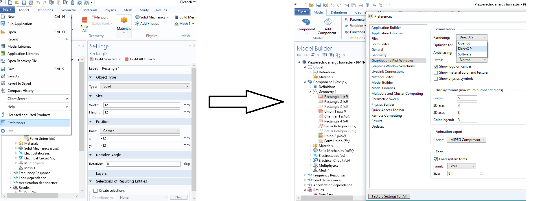

I found a solution:
On the prefrences, I changed the graphic software from OpenGL to Direct9X.
I found a solution: On the prefrences, I changed the graphic software from OpenGL to Direct9X.

The problem can also be solved for 5.0 by that changing. Great! Many thanks to Ron.

Wow, this helped me fix my problem with the graphics window as well.
Thanks!
Wow, this helped me fix my problem with the graphics window as well. Thanks!

Thank you changing the graphics software from openGL to DirectX works.

Thanks mate, this worked for my problem as well. I was unable to see the x & y values on my graphics window, OpenGL was the culprit.
