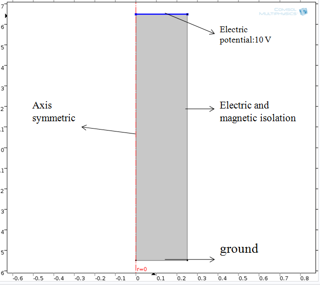

Posted: 1 decade ago Jan 21, 2015, 5:06 a.m. EST
hi Edgar, Ivar and others,
Thanks again for your help before. I am simulating a flow influenced by Lorentz Force and have a problem. Would you mind spare a little time to give me some advice ?
Liquid metal is good conductor. When i put a current into the liquid metal flow, a magnetic field will be induced and the Lorentz force thereof will influence the flow.
Because “magnetic and electric fields” is not suitable for a time-dependent flow , the COMSOL support had adised me to replace it with "magnetic fields"coupled with"electric currents". However, the results( magnetic B ) are completely different.
For simplication, i give a simplified model below.
Thanks.
wenzhi yang
hi Edgar, Ivar and others, Thanks again for your help before. I am simulating a flow influenced by Lorentz Force and have a problem. Would you mind spare a little time to give me some advice ? Liquid metal is good conductor. When i put a current into the liquid metal flow, a magnetic field will be induced and the Lorentz force thereof will influence the flow. Because “magnetic and electric fields” is not suitable for a time-dependent flow , the COMSOL support had adised me to replace it with "magnetic fields"coupled with"electric currents". However, the results( magnetic B ) are completely different. For simplication, i give a simplified model below. Thanks. wenzhi yang
Posted: 1 decade ago Jan 21, 2015, 5:39 a.m. EST
Hi Wenzhi,
you didn't couple mf and ec. You have to add an External Current Density to mf that takes the current density calculated in ec.
Cheers
Edgar
Edgar J. Kaiser
emPhys Physical Technology
www.emphys.com
Hi Wenzhi, you didn't couple mf and ec. You have to add an External Current Density to mf that takes the current density calculated in ec. Cheers Edgar -- Edgar J. Kaiser emPhys Physical Technology http://www.emphys.com
