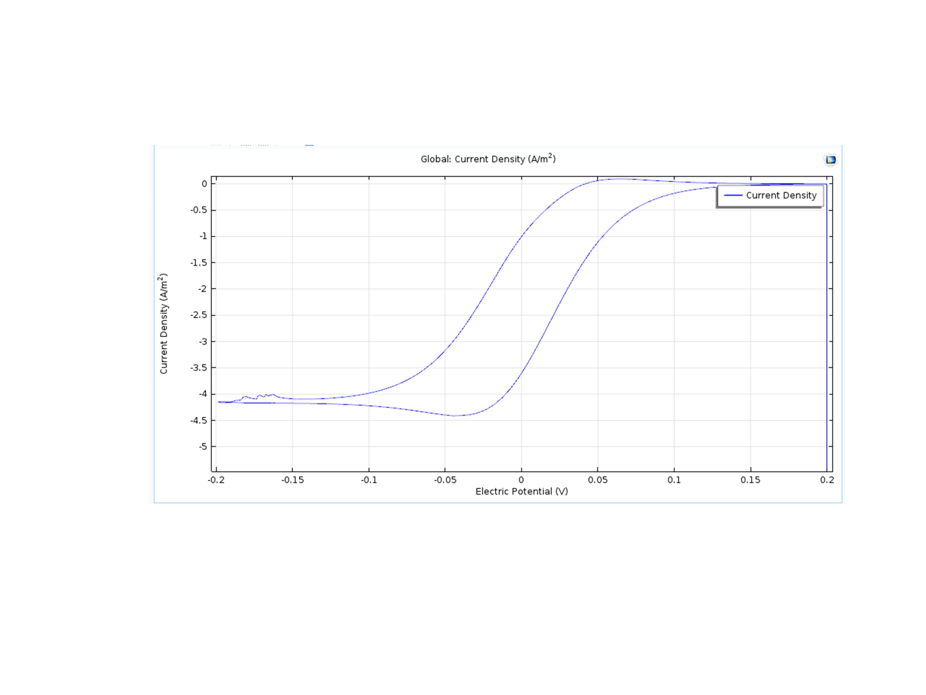

I got some result but limiting current is not what I expect to get.
I choose automatic meshing here in this results.
I got some result but limiting current is not what I expect to get. I choose automatic meshing here in this results.
