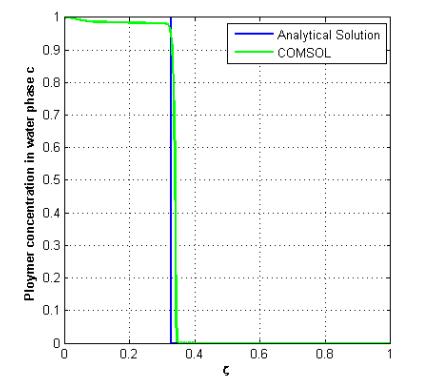

How to use COMSOL to solve problems with dimensionless time and distance but not conventional t and x???
In my model, I need to transfer the conventional mathematical model into dimensionless one. For example, transfer t into ι=t*u/n/L . Then I have to draw picture with dimensionless distance and time. How can I achieve that ???
The picture like one of the the COMSOL conference paper by Ben Niu?????
Thank you?

Posted: 1 decade ago Jan 26, 2015, 7:24 a.m. EST
Hello Lasse,
I have modified the model with the method you told me, but there is still some problems.
I want to repeat the model in this paper and make some improvements, draw the relations between c and dimensionless time.
Can you tell me how to achieve that??? Thank you very much.
Shirley
Hello Lasse, I have modified the model with the method you told me, but there is still some problems. I want to repeat the model in this paper and make some improvements, draw the relations between c and dimensionless time. Can you tell me how to achieve that??? Thank you very much. Shirley

Posted: 1 decade ago Jan 26, 2015, 8:17 p.m. EST
Get a relationship curve between concentration C and dimensionless time . But in the model the default is conventional time t, even I set the unit system to be non in the main surface.
Posted: 1 decade ago Jan 27, 2015, 2:55 a.m. EST
You need to make a global plot:
Results --> 1D Plot Group --> Global --> x Axis Data --> Parameter: Expression
There you can put your dimensionless time.
Wish this helps
Lasse
