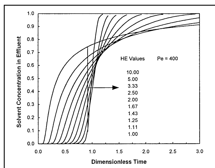

I have made a 1D model to calculate the concentration at the effluent point like the picture in the attachment. The x coordinate is time and the y is the concentration at the effluent point. But I can only achieve the concentration of the whole point but not the point.
How can I achieve this ??

I do not understand your question. What would you like to plot? At a particular time or across the entire domain?

I just used the Point Probe to obtain the change of c with time at a given point.
It can achieve this. Thank you.
