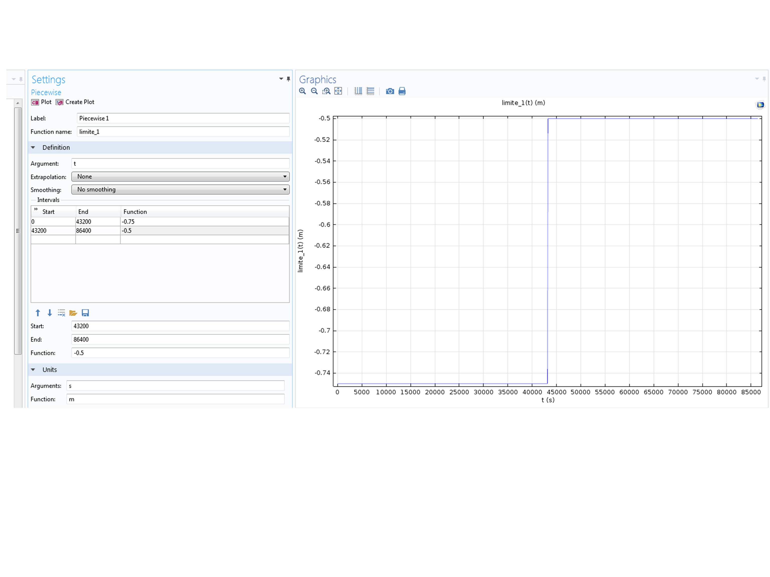

Have you defined the units of the argument (t in your case) and the function? See attachment. Function is piecewise.
br
Lasse
