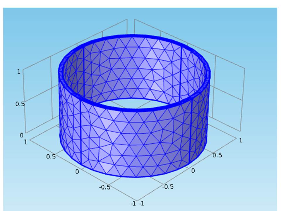

Posted: 1 decade ago Feb 10, 2015, 3:28 p.m. EST
No problem, if you first mesh the inner surface. Look at the attached image.
Lasse
No problem, if you first mesh the inner surface. Look at the attached image. Lasse

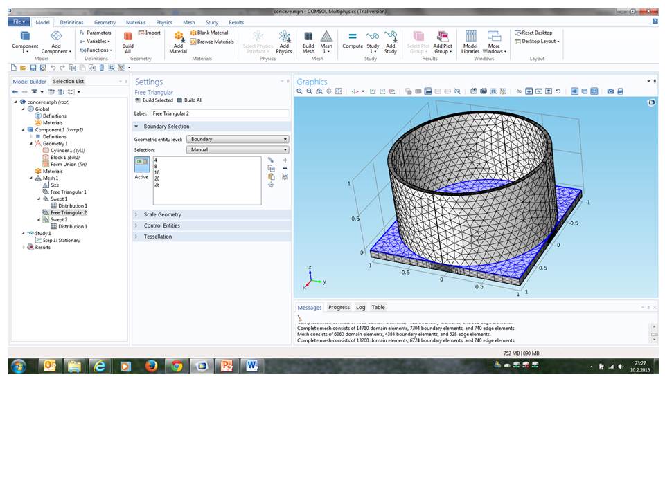

I was wrong, it was rather straightforward. First I meshed the tube, then the remaining parts of the plate surface. Finally swept mesh across the plate.
br
lasse
I was wrong, it was rather straightforward. First I meshed the tube, then the remaining parts of the plate surface. Finally swept mesh across the plate. br lasse
