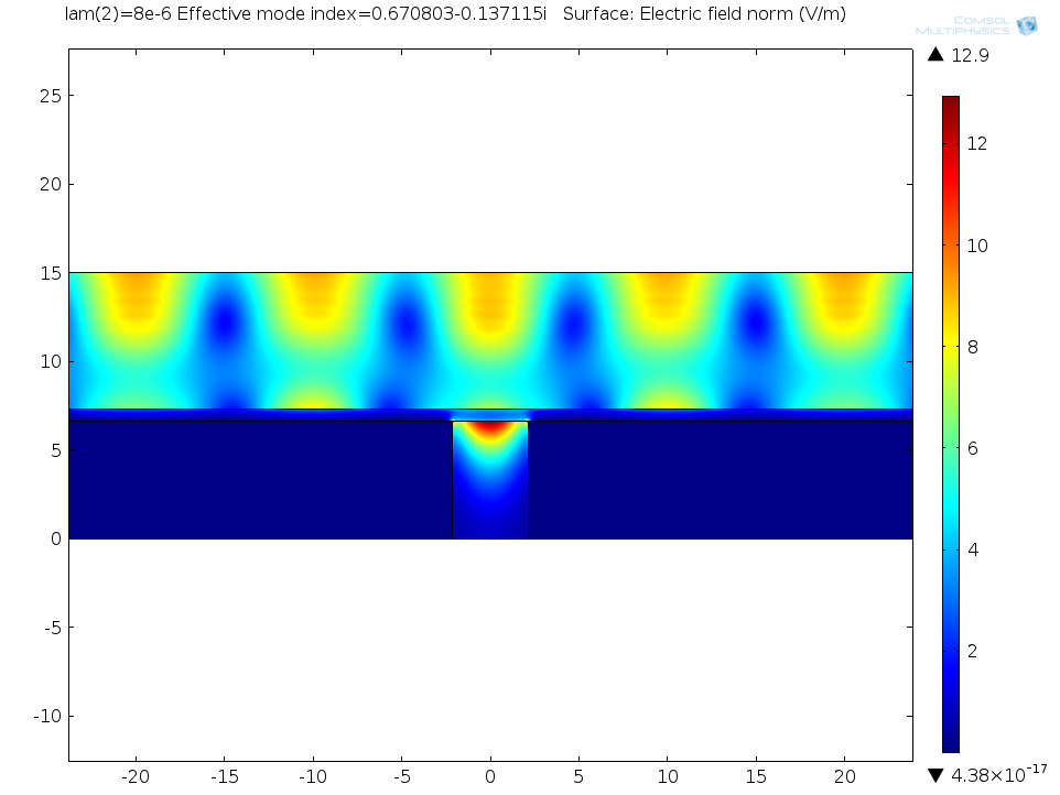

For the periodic BC, I suppose to use the "continuity" type right? But I looked after the previous post about periodic BC, it said that the continuity is somehow similar with PEC, why is that? and I know for my case I shouldn't use the floquet periodic because i can't define the kx vector.
I tried the periodic BC, and find the mode that I wanted, however, the mode kinda of spread out in the entire simulation area. I have attached the png file, you can see that there are some field distribution outside my waveguide. I am wondering how these parts will affect the effective index? Will they increase the imaginary part of the effective index?
Thanks,
Runyu
Hi Sergei, Thank you very much for you time and effort, it is helpful! For the periodic BC, I suppose to use the "continuity" type right? But I looked after the previous post about periodic BC, it said that the continuity is somehow similar with PEC, why is that? and I know for my case I shouldn't use the floquet periodic because i can't define the kx vector. I tried the periodic BC, and find the mode that I wanted, however, the mode kinda of spread out in the entire simulation area. I have attached the png file, you can see that there are some field distribution outside my waveguide. I am wondering how these parts will affect the effective index? Will they increase the imaginary part of the effective index? Thanks, Runyu

and also, does COMSOL has the function that allows me to do some post-calculation/manipulations?
like truncate a specific area and re-calculate the neff?
Thanks,
Runyu
and also, does COMSOL has the function that allows me to do some post-calculation/manipulations? like truncate a specific area and re-calculate the neff? Thanks, Runyu
