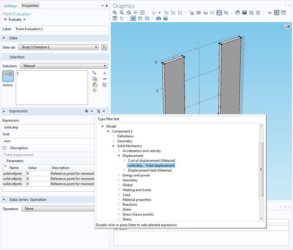

I would like to determine the displacement of a point of a leaf spring.
Unfortunately, the result is highly different from the actual construction, I proceeded as follows:
- 3D Model
- Solid Mechanics (solid)
- Stationary Study
- Geometric Imports (Figure 1)
- Material (brass: E=110[GPa], rho=8.44[g/cm^3], and nu=0.37[1])
- add Fixed Constraint 1 (Figure 2)
- add Boundary Load 1 as Total force in y (Force_y = 40[mN] Figure 3)
- add Point Evaluation Y (Select Point Figure 4)
- use expression Model -> Component 1 -> Solid Mechanics -> Displacement -> solid.disp
or Displacement field, X, Y and Z component
is this right? The values in the experimental construction are be much higher.
