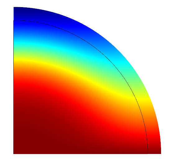

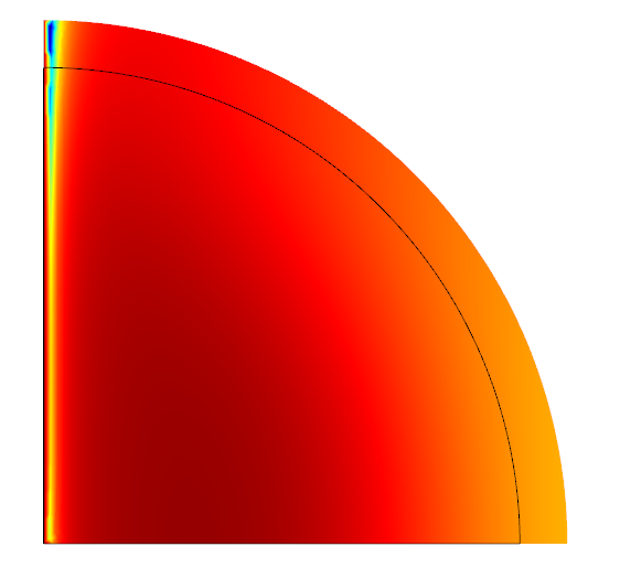

I found if I use 'd(solid.pm,r)' to calculate the derivative of pressure along the r direction, the result is very weird, like the Figure 1.
However, the 'd(solid.pm,z)' can give me the right distribution of derivative of pressure along the Z axis. as shown in the Figure 2.
Can anybody tell me the reason?

In axial symmetry, the analytical expression for the strain in the circumferential direction is
When the radius approaches zero (on the z-axis) this expression becomes problematic from the numerical point of view.
So when you take a derivative of the stress, the underlying operation will be to compute the r-derivative of the expression above. This is why you see disturbances close to the z-axis. The result will be very sensitive to the mesh size at small r-coordinates.
In the formulation. we do take measures to avoid zero-divide in the strain itself, but that does not protect against taking derivatives of it.
Henrik

I just realized the major issue here: The derivatives should be taken with respect to to 'R', not 'r'.
A quote from the user's guide:
"From a simulation perspective it is desirable to solve the equations of solid mechanics on a fixed domain, rather than on a domain that changes continuously with the deformation. In COMSOL Multiphysics this is achieved by defining a displacement field for every point in the solid, usually with components u, v, and w. At a given coordinate (X, Y, Z) in the reference configuration (on the left of Figure 2-4) the value of u describes the displacement of the point relative to its original position. Taking derivatives of the displacement with respect to X, Y, and Z enables the definition of a strain tensor, known as the Green-Lagrange strain (or material strain). This strain is defined in the reference or Lagrangian frame, with X, Y, and Z representing the coordinates in this frame. The displacement is considered as a function of the material coordinates (X, Y, Z), but it is not explicitly a function of the spatial coordinates (x, y, z). It is thus only possible to compute derivatives with respect to the material coordinates."
Henrik
Hi, I just realized the major issue here: The derivatives should be taken with respect to to 'R', not 'r'. A quote from the user's guide: "From a simulation perspective it is desirable to solve the equations of solid mechanics on a fixed domain, rather than on a domain that changes continuously with the deformation. In COMSOL Multiphysics this is achieved by defining a displacement field for every point in the solid, usually with components u, v, and w. At a given coordinate (X, Y, Z) in the reference configuration (on the left of Figure 2-4) the value of u describes the displacement of the point relative to its original position. Taking derivatives of the displacement with respect to X, Y, and Z enables the definition of a strain tensor, known as the Green-Lagrange strain (or material strain). This strain is defined in the reference or Lagrangian frame, with X, Y, and Z representing the coordinates in this frame. The displacement is considered as a function of the material coordinates (X, Y, Z), but it is not explicitly a function of the spatial coordinates (x, y, z). It is thus only possible to compute derivatives with respect to the material coordinates." Regards, Henrik
